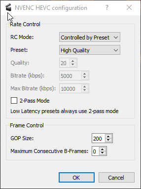

Why are my output files in such low quality when I use HEVC? A 1GB file becomes like 20MB and the quality is terrible. Here's how the configuration looks, haven't touched anything:
How can I fix this?

Try changing the settings, especially the "controlled by preset" drop down box . That might unlock some of the other options instead of "greyed" out
I'm using Avidemux, thought I'd try this relatively new Nvidia encoder as I've got a Nvidia GPU.
What I did was I loaded the video to Avidemux, changed the Video setting from Copy to Nvidia HEVC, and just exported it from there. When I went back to check the settings, it's what it looks like in the screenshot in the OP. I can't change the bitrate or anything as it is greyed out, the only things I can change in the settings are these:

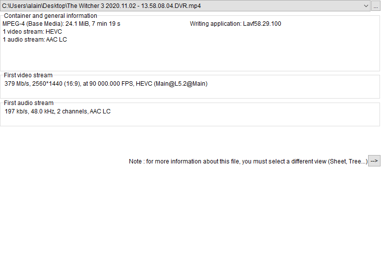

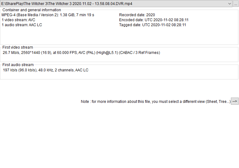

Here's the MediaInfo you requested:

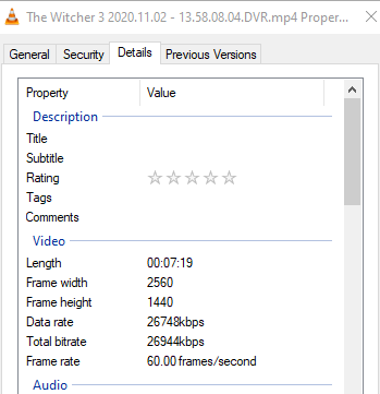

copied this (the total bitrate):
With those settings I got this:

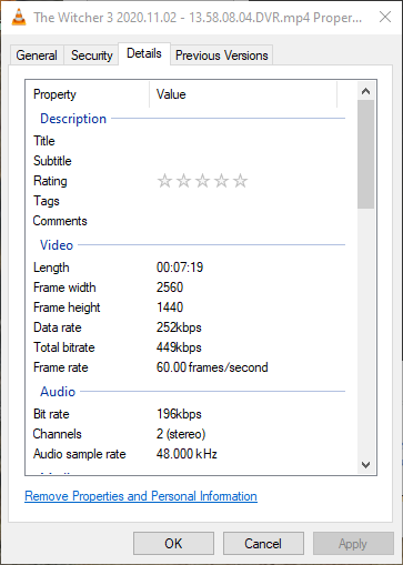

And for some reason MediaInfo shows a different higher bitrate:
What am I doing wrong?Last edited by Jiehfeng; 24th Nov 2020 at 11:49.

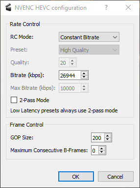

This is what I did so far, I'll test to see what I get:

What card do you have ? Older ones did not support b-frames for HEVC, or maybe you need to update driver
b-frames improve compression efficiency at typical bitrate ranges (They are bidirectionally predicted frames), with diminishing returns (adding more than 2-3 helps less and less) unless using very low bitrates
max GOP size also compression efficiency at typical bitrate ranges also with diminishing returns , at the expense of seek latency (slower to navigate) . A typical high compression file might use 5-10 sec keyframe intervals . 10 seconds for 60fps is 600
Max bitrate is a restriction, that you should not use (it only decreases quality), unless some device or playback scenario requires it (some devices "choke" on bitrate peaks, or buffer underruns) . A general guideline if you can't disable it is to use some large value like 2-5x the average bitrate, or use the value that your playback scenario or device requires (some devices have presets or certain required values) -
