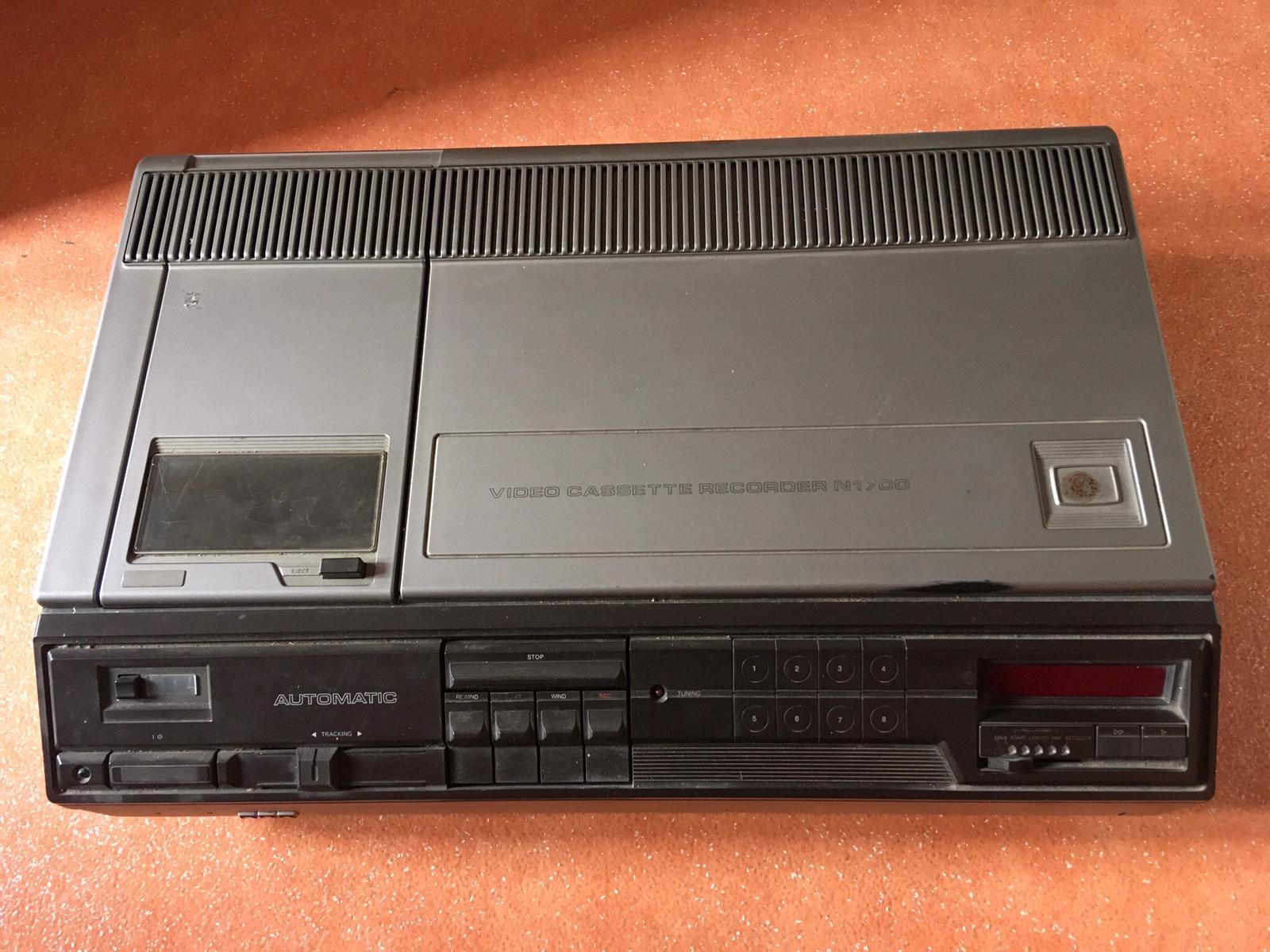

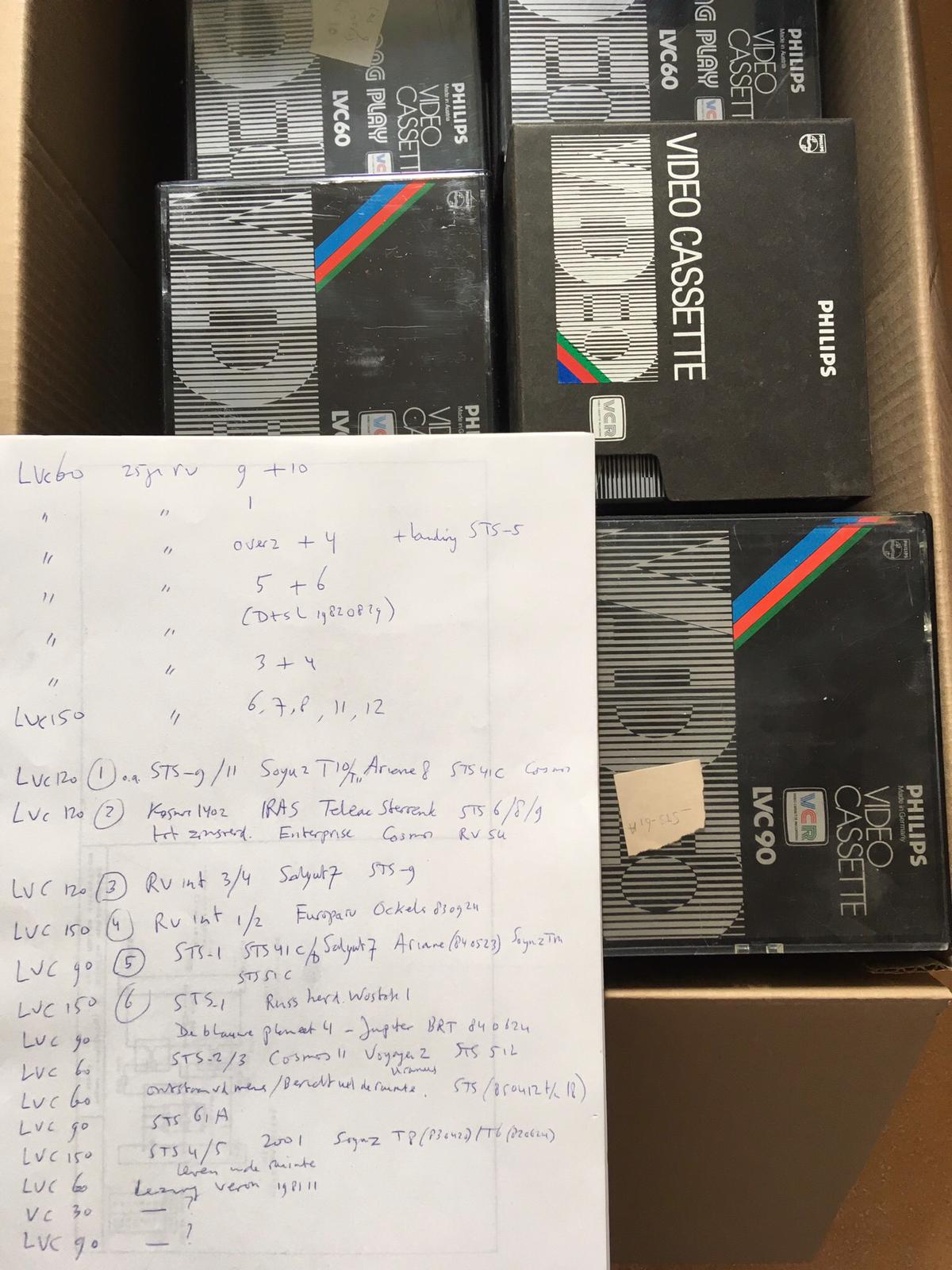

    This month, one of the other volunteers has done an interesting discovery at his basement: A Philips N1700 VCR with a ton of VC cassettes. He recorded these at the time.
    [Attachment 55946 - Click to enlarge]
    [Attachment 55947 - Click to enlarge]
    This collection is interesting because it contains early 80s home recordings of Dutch, Belgium and German broadcasts related to space exploration during this time. Including the Space Shuttle, Soyuz, Voyager probes and other such projects.
    Very fitting for the observatory archives and YouTube channels. A project I am really looking forward to digitizing...
    Currently I have not yet looked at the items in person, though I hope to soon.
    Here are some things I am going to check out and expecting to see:
    1. Condition of the tapes, has the binder remained intact, the base flexible. Is there mold, dust or dirt inside?
    2. Is the VCR in functioning condition? What is the condition of the video and audio heads?
    3. How to go about digitizing the tapes in the best achievable quality?
    I do not know in what condition the tapes and VCR were stored. Hopefully in a good, consistent climate...

    The owner brought the VCR and tapes. Together with a reel to reel audio tape and a small flatscreen TV monitor with analog in. Useful, because I don't have a TV with analog RF in. Flatscreen TV seems pretty old, with component and composite in also. Hopefull it works.
    VCL tapes all look good. Clean and shiny. No dust, dirt or mold inside any of them.
    Two belts have gotten hard, replaced them, one to the video head and one to the capstan. Counter belt seemed to still be OK, it counts so....
    Video head looks clean, heads still shiny. Cleaned them carefully with a chamois swab. Left a few streaks on the swab but that was it.
    Audio head looks slightly corroded, some green/blue spots on the front. Should be able to polish this off carefully.
    A clean machine overall, mechanism and electronics.
    First power on, clock works so at least those electronics and the PSU works.
    Without a tape it seems to sound OK. No inconsistent whirring or strange noises. Everything appears to work as it should.
    Tried one of the tapes I got already for testing purposes. The VCR opens the cassette up at the front and right parts.
    Wraps front tape around the drum. Top reels turns a bit to give slack for tape wrap up. So far so good...
    Pressing play pushes the pinch roller on the right against the capstan with the tape in-between, and the tape starts spooling on the top reel consistently. No weird noises, tape seems to run through the mechanism and around the head with ease. Audio head also gets pushed against the tape.
    Connected the RF out to the flatscreen TV and set the TV to search through the entire Mhz range.
    Alas... nothing. Just keeps on searching in a cycle. No signal.
    I tried connecting RF out of the Philips VCR to my S-VHS VCR and then S-Video out to my PC capture card. Nothing, either.
    What is the best course of action? I do have a Tektronix 2225 2-channel 50Mhz scope, I should be able to use this to measure the RF signal right? Don't know what settings to use.
    Does the N1700 have a set output channel, or was this user adjustable?

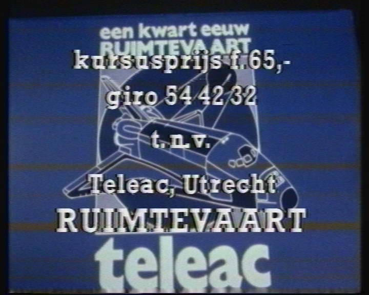

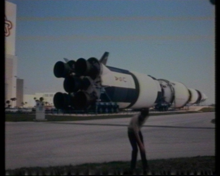

    I added some more captures I did with the live2usb. In some I think the bottom is missing?
    test1 even has a green bar on the bottom. I tried different softwares, each with different problems...

  17. I seem to have no luck with virtualdub... the bottom seems to be cut off, sometimes there is a big green bar. See uploads to gdrive.
    test1 was taken with virtualdub. Composite_(PAL_N) was taken with WinTV8.5. I think the netherlands used PAL_B but I don't see that option in the program. Only ntsc, secam and a few PAL options but not B.
    Only software that seems to be working well for me is Dscaler, I think its the entire picture. But it seems to save it very stretched... even though I set aspect ratio to 4:3/1.33.
    291mb file of Dscaler capture.

  18. I doubt PAL-N would be correct, as it's the system used in some South American countries and is different to a normal PAL signal. You want whichever of B/G/D/K/I that are available, they are all the same over composite, the difference between those just lies in how they were broadcast over the air (so only relevant if you were to capture from an RF output).
    Green bar or cut off can sometimes be caused by the capture resolution (should be 720x576 at 25fps for PAL/SECAM) not being set correctly, you want to make sure both the resolution and system is set properly. The resolution isn't always switched automatically after switching system.

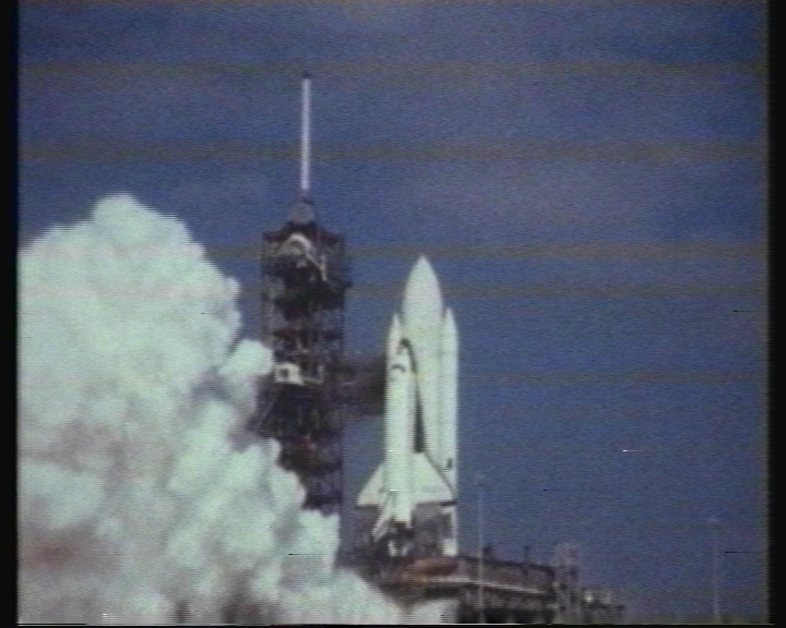

  20. Good news! WinTV-HVR 1700 arrived, and it gets rid of all the capture problems with the USB video grabber.
    In virtualdub2 the capture is very stable throughout the tapes I have tried. It reports 0 dropped frames, and only inserts frames when it plays a bad spot on the tape and the video signal glitches out completely, which it does even on my TV.
    So at least I am able to capture now without any problems. I read on this forum that it is best to capture in high quality without ANY filters at all. I capture with virtualdub2 to AVI in h265, 8-bit YUV 422 and CRF/Quality set to 10, fast profile. Captured directly to my video-editing SSD and got about 20-30% CPU usage. Captured as PAL-B, which was used in the nertherlands I think.
    Unfortunately the picture is very shaky horizontally all around, as if the two interlace fields are on offset of each other? Not sure if this is normal. When de-interlacing the picture is very shaky.
    Lines are also not aligned well... and move horizontally.
    Here is an h265 capture, unedited. Excuse the large file, 1.8gb. https://drive.google.com/drive/folders/16t0nDgYxrKMKwLXGxVigrBZvGQL35vEL?usp=sharing
    Will most of the shaky video capture be remedied with a DVR TBC passthrough? Or is it caused by something else.
    Unfortunately I do have to use a composite RCA to S-video converter plug, because the card supports only the latter as video in. Hopefully that isn't the cause of any problems. Would it be worth getting an capture card with native composite in?
    The audio capture on the card is clipped on virtualdub2, so I capture audio with a soundblaster USB DAC. This causes a desychonization between the audio and video. Can audio sync be adjusted in virtualdub2 so its captured in sync with the video?
    Thanks for being very helpful.
    Yep, see post #15. For the audio it should be a setting to adjust audio level for the capture card in the OS audio menu. For composite yes it would be better to have the capture card handle composite on its own, your converter may not be doing a great job.
  22. Yeah being shaky horizontally is pretty normal with those capture cards, the conexant chips they use are not very good at stabilizing things horizontally. A Panasonic DVR should help fix that (though if using a panasonic one you want to mod the cable or dvr to reduce the video input level a bit as e.g described here). Alternatively, if you can't get hold of one of the panasonic ones there are some other models that can help to varying degrees.
