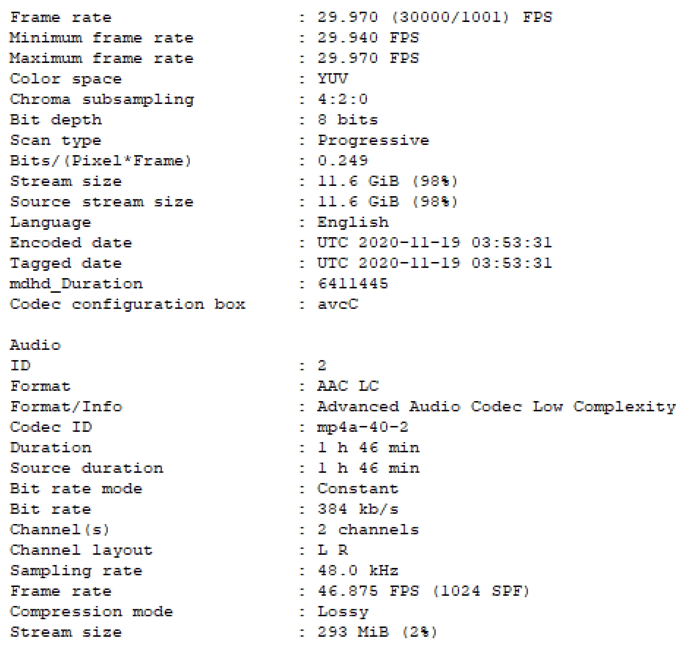

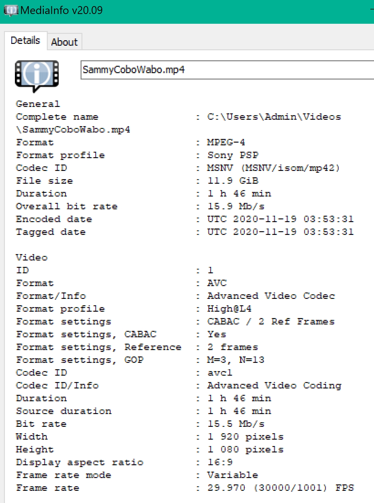

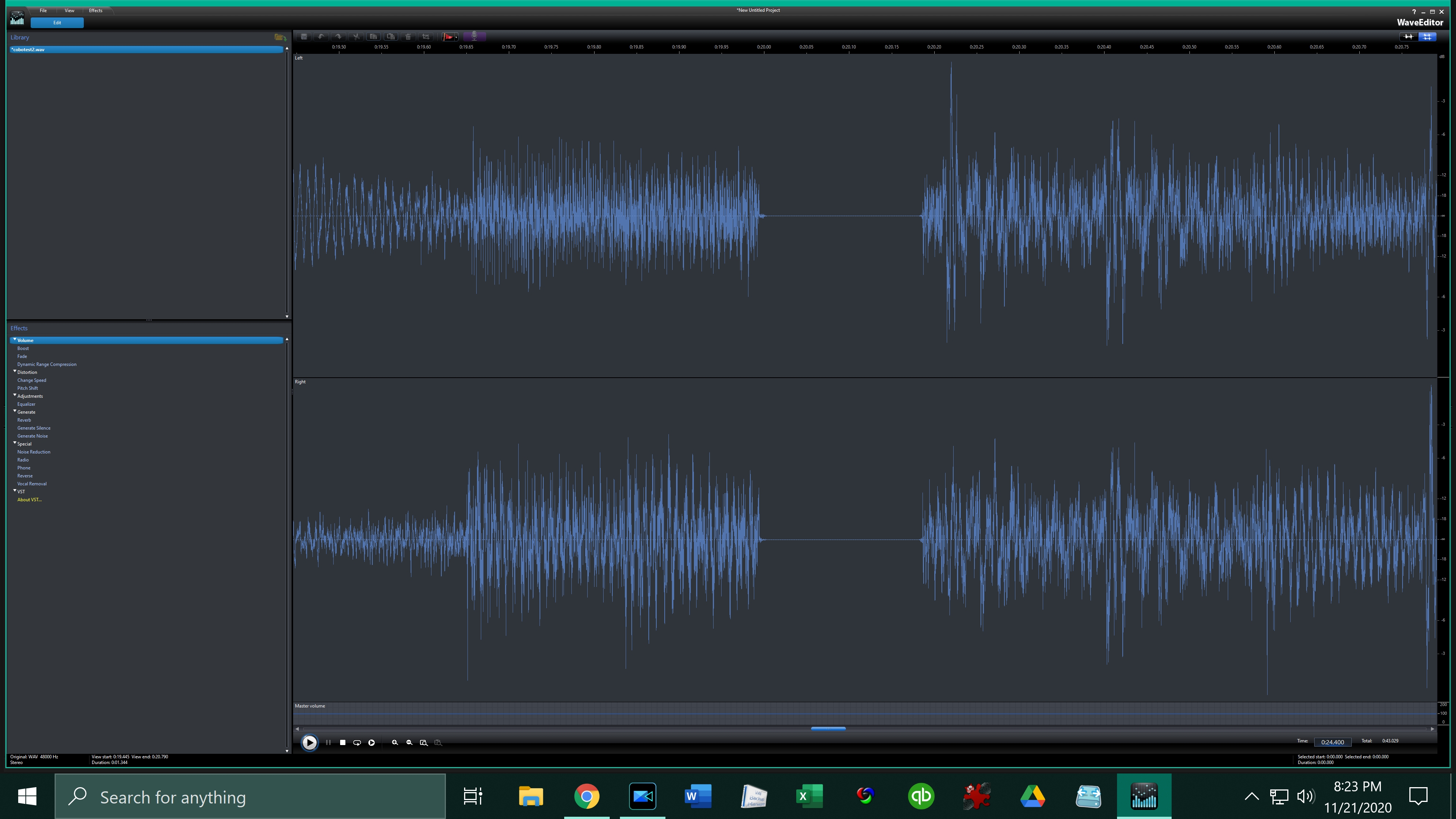

    So I have tried several different methods/programs to get these dead spots out. They appear approx. every 20sec. and are about a quarter sec. long. I honestly can't tell if the Video is messed up as well but it appears that there are several frames exactly the same at the same time as well. I have tried bringing it into powerdirector and saving it out in several different formats with different frame rates from 24-120 and several different codec/formats and one conversion program. I am including the video info I have for it as reported. Image
    [Attachment 55933 - Click to enlarge]
    [Attachment 55934 - Click to enlarge]
    Any help would be greatly appreciated.

  5. The waveform shows you have drop-outs in the audio. It can happen with poor captures (just like dropped frames for video).
    if keeping the original audio is important:
    - either cut them out
    - or fill them with your clips background noise (it's the simplest to keep sync with video, but it doesn't help if the cuts occur during speech for instance). It can be done manually with Audacity.

    bitrate is 10Mbps at 1080p. The video quality is poor >> you could reencode and save bitrate.
    There are short blanks in the recorded audio approx. every 20s as reported.
    You can either cut frames with missing audio and re-encode (ex: with Avidemux).
    Or fix the audio with Audacity (preferable unless the cut can't be filled adequately) while maintaining sync.
    It's a fair bit of work to do manually though for 1h40min (300cuts ?). Also, odds are some of the cuts will be jarring.

  11. If you extract the audio and open in a hex-editor you will see the content corresponding to the audio drop-outs is almost entirely filled with zeros >> it's a capture issue in the source file.
