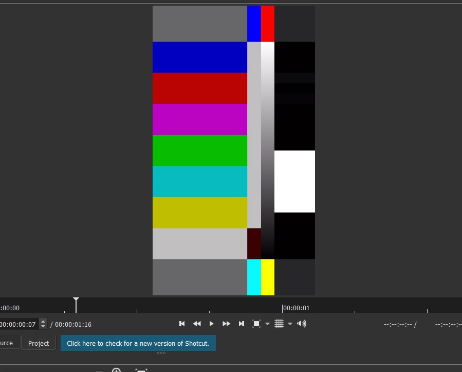

Are you sure the images are 1080x1920 ? width x height ?
worked ok for me
[Attachment 55927 - Click to enlarge]
Did you set aspect ratio to 9:16 , and 1080x1920 for the export ?
export from shotcut was ok too
1080x1920.mp4 attached
youtube is also 1080x1920 (it took a while for that version to pop up), but the player displays it as pillarboxed in a browser with white background in the small player
https://youtu.be/TFk9HV--6PE -
youtube doesn't serve it has 1080x1920 in mp4/avc though. Only in webm/vp9.
