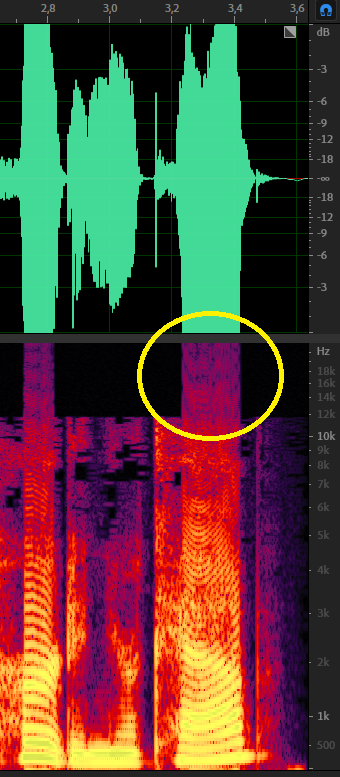

  1. My audio file pcm_f32le has some values above 0 db. I'd like to cut/clip everything above 0. I know that I can use alimiter or loudnorm but the goal is to make values more than 0 to be equal to 0 and keep everything else unchanged. I cannot find appropriate command for this in the documentation.

    I want to cut everything above 0 and nothing more.
    First, there is NOTHING above 0. Digital signals go up from -XXdB (depending on bitdepth) to 0dB. There is nothing above that. Greater than 0dB exists in the analog world because they utilize a thing called "headroom". Thus, there is a spread above 0dB for consumer gear (usually ~10-14dB) and professional gear (usually ~18-24dB) to accommodate signal peaks while avoiding the onset of gross distortion. With digital, once you hit the 0 ceiling, you clip and have massive distortion (because the clipping creates what amounts to a square wave, which is high in odd harmonic distortion).
    BTW, best practices of pro audio is to always set the nominal level at ~-18-24dB or so, to accommodate the digital equivalent of headroom.
    Second, your example looks to already be clipping. IOW, it has already removed any signal that would have been above 0dB.
    Note that your 2nd pic is a frequency-based plot. Yes, because of the clipping, and the square-waving, you have those added odd harmonics (aka spurious aliasing artifacts, which unfortunately are also correllated with the signal and so are even more noticeable than non-correllated noise). Those are what you are seeing in the frequency area above the normal limits. Those harmonics are lower in level (remember, you're not seeing LEVEL on the X or Y axes of the plot, except by looking at the intensity of the color - notice that the bulk of the intensity is in the lower frequencies).
    Third, why on earth would you NOT want to un-clip? The way to restore the signal properly (beyond the preferred method of re-capturing using proper signal levels to begin with), is to un-clip. Un-clipping will result in the overall level of the signal being reduced to accommodate, and then synthesizing the peaks (based on sinusoidal extrapolation). This will do what I believe you are ultimately wanting to do, whether you realize it or not.
    Fourth, I don't know of any command-line tools that are worthwhile that feature un-clipping (aka "clip restoration", "peak restoration", etc).

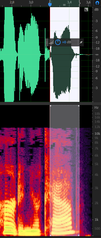

  7. I selected clipped area, reduced the volume and got all clipped information back. My file is in float format pcm_f32le.
    [Attachment 55920 - Click to enlarge]

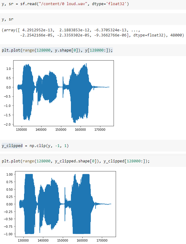

    I think I can open wav file as a numpy array and then replace all values above 0 with 0.
    [Attachment 55921 - Click to enlarge]
    But I'm not sure what is the right range for pcm_f32le [-1.0, 1.0) or [-1.0, 1.0] or (-1.0, 1.0)?
