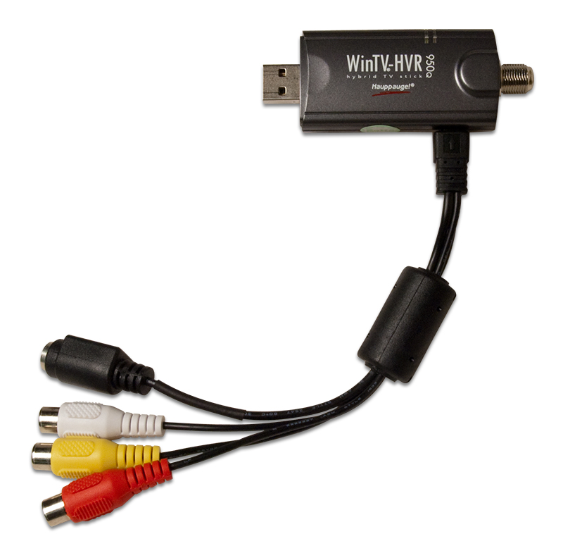

    The Hauppauge WinTV-HVR-955Q model 1191 comes with a breakout cable for analog SD audio and video input. (The WinTV-HVR-955Q is an updated version of the WinTV-HVR-950Q shown in the picture below.)
    [Attachment 55879 - Click to enlarge]

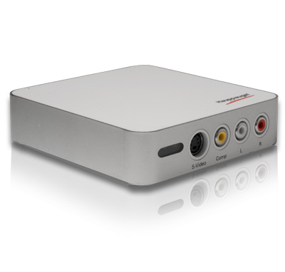

    I was going to suggest this USB tuner/capture device as well but it is discontinued and I did not find the US version on eBay: https://www.hauppauge.com/pages/products/data_hvr1955.html
    this what you're looking for ?? - https://www.ebay.com/p/2264274579

    No. The item I was looking for on eBay was the WinTV HVR-1955, which is discontinued.
    [Attachment 55882 - Click to enlarge]
    An updated version of the WinTV HVR-950Q, the WinTV HVR-955Q, is still in production.
    did find a used one - https://www.ebay.com/itm/WinTV-HVR-1955-Multiformat-Video-Capture-with-TV-Tuner-KIT-/392971696007
    and 2 more - https://www.ebay.com/sch/i.html?_from=R40&_trksid=p2380057.m570.l1313&_nkw=WinTV+HVR-1955&_sacat=0

    Yes. Just plug the breakout cable into the 955Q and connect the video composite out and stereo audio out from the PVR to the matching connection on the breakout cable and set up WinTV 8.5 to record. The WinTV software will encode the video and audio streams received via USB. Hauppauge devices capture closed captions received via USB in another separate stream instead of in the GOP user data like some other devices do. CCExtractorGUI is designed to extract the closed captions as SRT subtitles from that stream as well as from GOP user data.
    WOW. Well ok then!
    WOW. Well ok then!
    Was expecting some kind of way more exotic, head scratching process that would cost an arm and a leg, but certainly not looking a gift horse... Already picked up a 955Q, it's on its way and so should prove very useful for upcoming rip sessions. Have you had good results for accuracy and timing with the SRT's generated by CCE from sources you have captured? Just trying to get an idea of what to expect...
