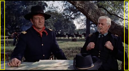

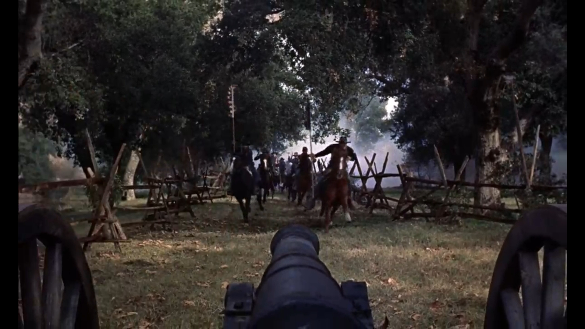

  2. Here a screenshot of what is claimed to be the original trailer. It's 1.66:1. One sees the black sidebars on the 16:9 screen. Same as davexnet's HD version in post#177. Back to field zero.
    Strange to find screenshots of 1.85:1 with clearly extended picture content though. Maybe it has never been released as DVD or BD in the 1.85 format.

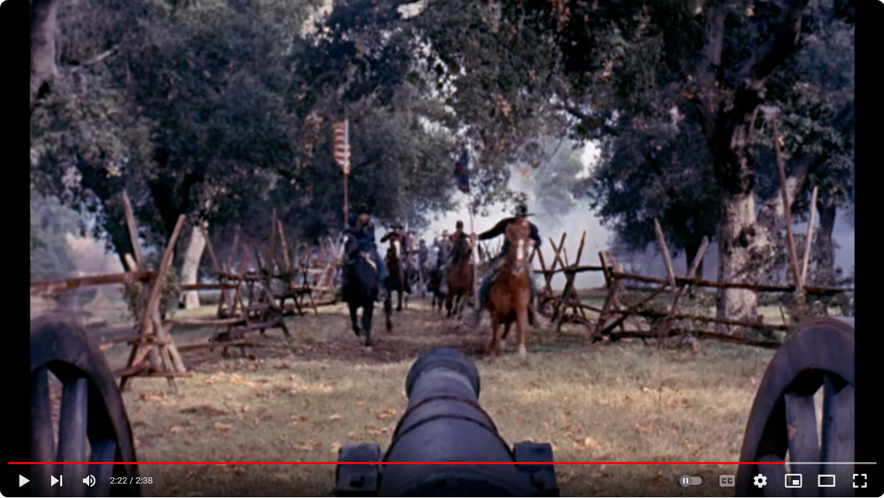

  11. I tried 2 YouTube type downloaders i have & neither would work with the video that davexnet posted.
    I have another one I will try but I do not expect it to work either.
    I did take a screen shot as close as I could to the one Sharc posted in #182.
    I had to take it in motion to get the full screen with no player visible.
    To me it shows a bit more screen.I can see more of the cannon wheels.
    This could be because of the frame the screen capture is from.It is more screen than the 1.66.1 on the dvd.
    [Attachment 80839 - Click to enlarge]

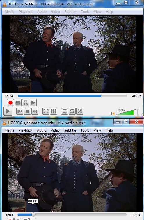

    Just for a 'giggle', I took this 'HQ' version, upscaled that to 1080p (hence the small letter-boxing for 1.85:1 and compared that, suitabley upscaled, with the 1:66 DVD version what we only had before.
    The result can be assessed in the comparison of the same frame - I think - from both. Sure, there is more info on all sides in the HQ. But when one considers how much extra info left and right to get that to 1.85:1 is required casts doubt in my mind that this newish (2022) bluray is really 1.85:1. Of course later in the film there may be sequences to justify that but not in the samples we currently have. And this is a film that I have no desire to obtain. It is only available Region A (not a playback issue for me) and, as stated, all other blurays are 1.66:1.

    I compared the screenshots the upscaled video is a lot darker & more space over the men's heads because they are smaller..

    As for the 'darker' video, you are missing the whole point of the comparison. And the 'smaller heads' is just nonsense.
    But if you do get that bluray pls come back and post at least a cap since curiousity has got the better of me.
    I meant the men were smaller but the heads are smaller too.
    Click the link & compare them with the slider
    https://imgsli.com/MjgwNjE0
  17. Member DB83's Avatar
    Jul 2007
    ^^ You may have a long wait for a cheaper one. Even Ebay ones are as expensive right now.
    OK. You do realise what happens if you zoom out on an view.

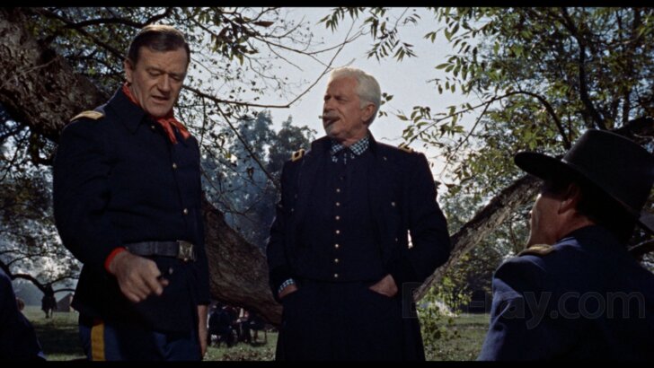

    Anway, I found a review of the 'new' blu ray online
    https://www.blu-ray.com/movies/The-Horse-Soldiers-Blu-ray/301244/#Overview
    Loads of screen caps (not full size) but here is an example - original screen cap 728 * 410 (1.78:1 as you would expect). letter-box bars cropped = 728 * 390 (1.85:1) But is there more info than on the HQ file ? I think not and some of the caps just do not look right.

    I took a closer look at the online version and compared that to the screencap above. What my eyesight tells me that there is information missing top and bottom on the new bluray whereas left and right are as close as damn it. I made a short clip suitable scaled that turns the 1.66:1 into 1.85:1 (or as close as I can) and you can then compare the cap to the new vid.

    Like I said, there is more information on the online version than on the dvd that we were working from before. The major difference is that the online version is 25 fps and the 'new' bluray is only available state-side.
    It is possible that different cappers get a different take since the AR on the two caps is slightly different. Not enough to lose any sleep over.

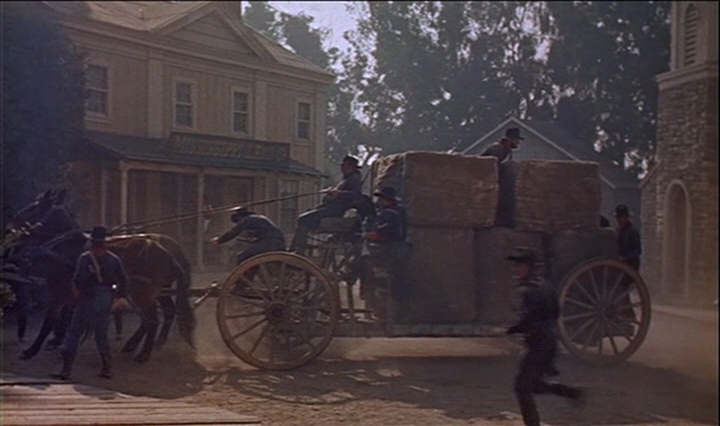

    I reckon this is pretty close (the line of sight is just slightly down, so the wheel will look to be a smidgin wider):
    [Attachment 80911 - Click to enlarge]
    I resized it manually using trial and error in VDub using a screen capture app for the dimensions.

    Yeah, I saw that. I think it's close. Perhaps 720x432 or 800x480 for the earlier 1.66 A/R that was mentioned.
    Ithink we've gone around in circles ourselves by now
  28. Originally Posted by davexnet View Post
    I think we've gone around in circles ourselves by now
    Indeed, since long we have just been wasting our breath. The wheels.vob of post 204 is simply wrong, horizontally stretched and distorted (flat tires? ).
    The cover says it's 1.66 (the former estimation - before seeing the cover - was ~1.65, sic). Then there is the NTSC DVD standard and basic maths.
    Ignoring all this one may continue with some clueless tinkering forever.

    This is from the conversion to .mpg with ffmpeg.
    Similar to Sharc's "zoom and crop, keeping the proportions intact".
    I used my crop=720:390:8:43 but Sharc's scale=720:480.
    [Attachment 80925 - Click to enlarge]
    This is from my ffmpeg conversion to .mp4:
    [Attachment 80926 - Click to enlarge]
    This is that .mp4 converted back to DVD format with AVStoDVD.
    This is from the video in post #204.
    Height Width
    177 px 187 px
    1.7 in 1.609 in
    0° 90°
    43.18 mm 40.87 mm
    Shows width 10 pixels wider.or .091 inch
    [Attachment 80927 - Click to enlarge]
