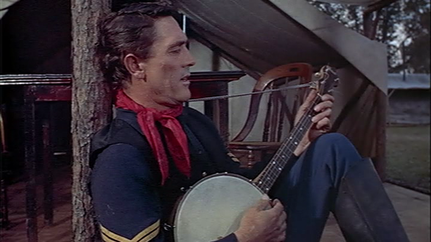

  6. Originally Posted by DB83 View Post
    And cholla's earlier comment that you can not take a 4:3 dvd to a 16:9 dvd without stretching is simply wrong.
    My impression is that he may be confusing 'stretching' with 'zooming/cropping' (?)
  7. Originally Posted by Sharc View Post
    File in post #113 HORSE(02)cut.vob: Apparently AVStoDVD did not apply pulldown flags for telecining but just converted 23.976p to 29.97p by simply repeating every 4th frame like abcddefghh...... Not the smartest conversion method.
    I haven't been using AVStoDVD since long, but doesn't AVStoDVD have a decent 2-3 pulldown option? Its HCenc encoder provides for this AFAIK....
    (apart from the stretching,but @cholla prefers it this way).
    Edit: I gave AVStoDVD a quick shot using the original HORSE(01).vob as input. It produced a correctly soft-telecined output here, means it preserved the pulldown flags.
    Tried the file of post#106 HORSE(06)cut.mp4 as well. Output produced by AVStoDVD is correctly soft-telecined here.
    So maybe it's just an issue with the file HORSE(02)cut.vob in post#113 which has lost the pulldown principle for some reason, or a wrong configuration/setting option (?) in AVStoDVD when this file was produced.

  8. Originally Posted by Sharc View Post
    How did you create this one? Frame repeats producing judder, .... Did you deinterlace instead of IVTC?
    Most important however that you are happy with your production and it works for you.
    This was my procedure on this video:
    I ripped it from a DVD with CloneDVD2.
    I then joined the .VOBs with joinvobfilestool
    I converted this with FFMPEG to .MP4 .
    Then back to DVD with AVStoDVD.
    Then burned to a test DVD +RW with ImgBurn.
    FFMpeg I used dejudder & the fallback to yadif=deint=interlaced
    I did not use IVTC .

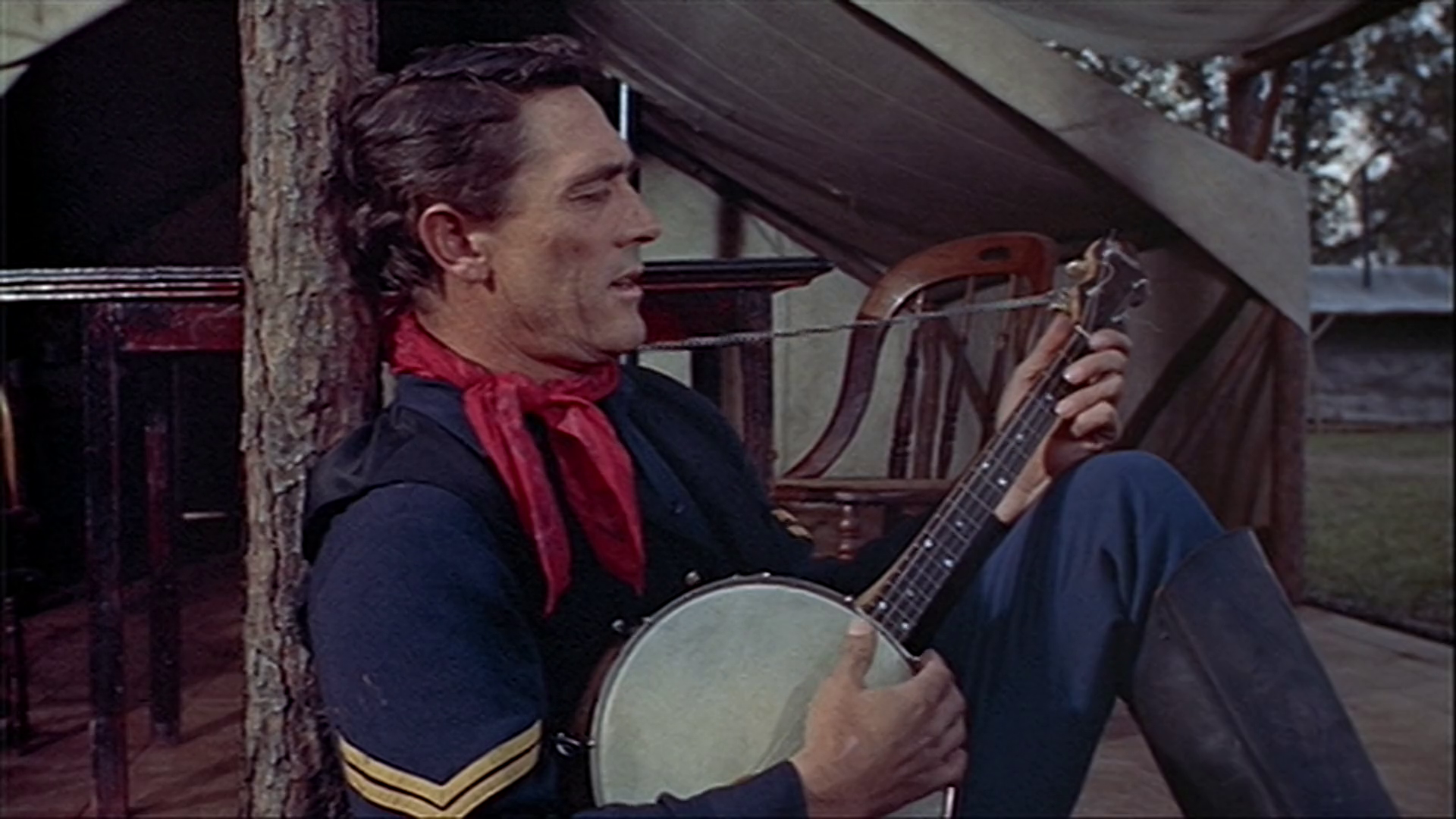

    Just to illustrate my earlier point, I have also prepared a short sample from the original vob but this time only cropping away the letter-boxing. Now one gets a height of 390 pixels but to retain the 16:9 aspect ratio you end up with a width of 664 pixels then filled with side-bars back to 720 pixels. Simply resizing the 664 to 720 you get that horrible stretching.

    Now I note that you have conveniently ignored my earlier contribution. Sure I was blunt in my appraisal of your desired output. One day you may see the error of your ways..
    @ DB83, I wasn't ignoring you. I disagreed with you.
    But here goes.
    Cholla, that sample which you are 'happy' with is terrible. As others have mentioned, the aspect ratio is well off so everything is wider/fatter than it should be.
    It is some wider than the original & I expected that. Neither you nor anyone else created a video that was 1920x1080 that was not wider than the original 4:3.
    The topic you quote from was specific since the member was having issues with the program.
    A2DSource is an 'all-in-one' and covers all the other options from that pulldown. If that worked for you, I see no need to change.

    I decided to post pictures instead.
    The left picture is from your HORSE(01)_cropped+resized.mpg (321.89 MB, 5 views) after AVStoDVD.
    The right picture is from my wider video.
    In mine there is more vertical picture.
    [Attachment 80613 - Click to enlarge]
    [Attachment 80614 - Click to enlarge]
    Yours after AVStoDVD did display full screen on my TV played through my BD player.
    Also on VLC set to full screen.
