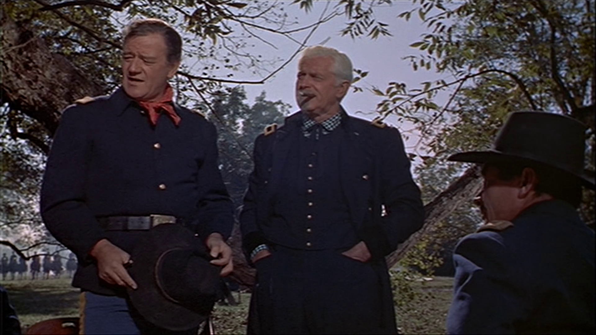

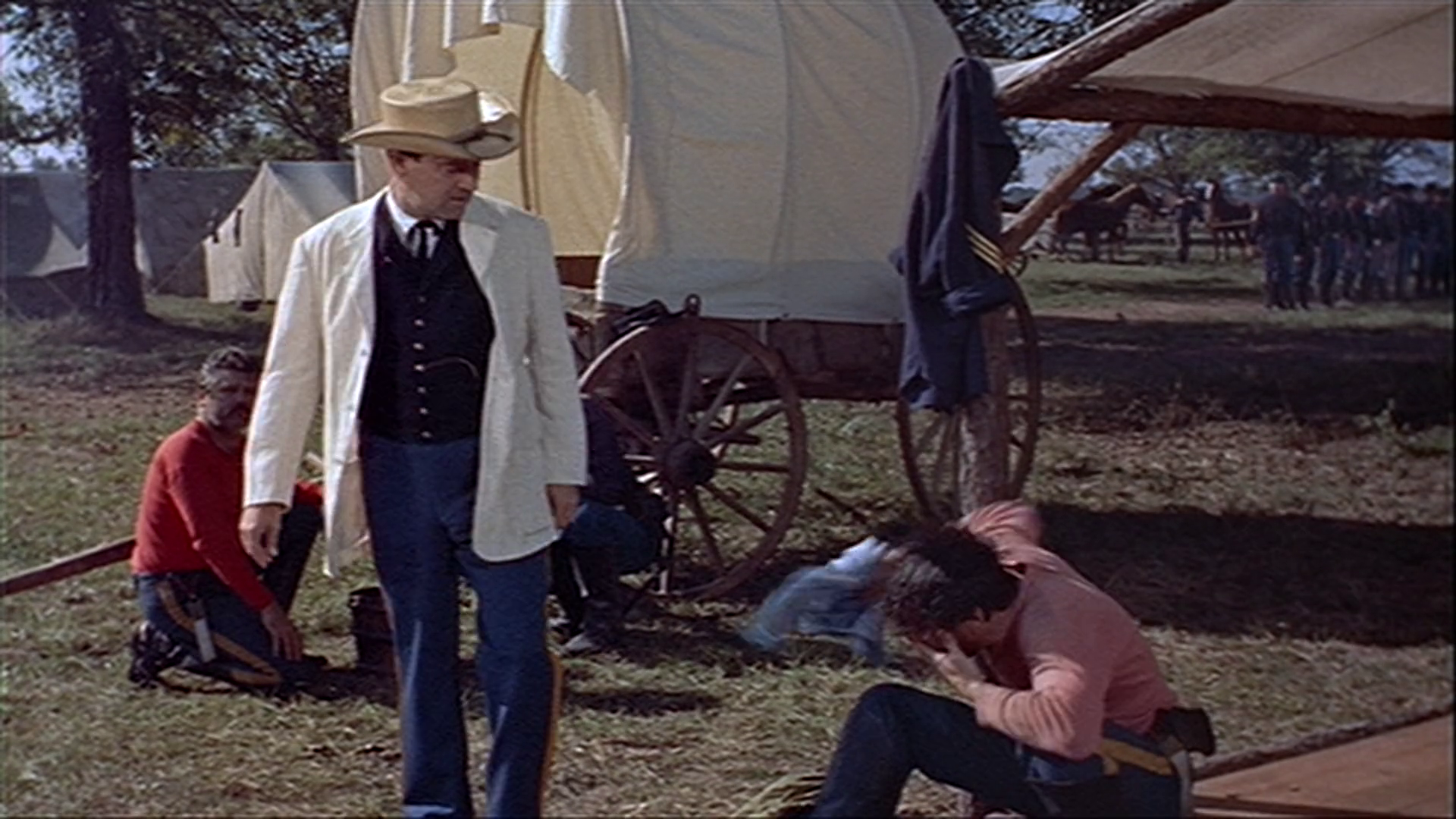

    I made these measurements with VLC player & a ruler on a 24" monitor set to 1920x1080.
    The original DVD rip 720x480 Man in middle 1 is 3 1/4" at shoulders. Man 2 in white coat is 2 5/16" at shoulders.
    jagabo's was the least stretched the resolution was 1920x1164.
    HORSE(01) 880x540 6k.mp4 Man width 4"but this video is not 1920 x1080.
    HORSE(01) 1280x720_.mp4 Man width 4 1/16" but this video is not 1920 x1080.
    HORSE(01) 1920x1080_ffmpeg_.mp4 Man width 4 3/8"
    HORSE(01) 1920x1080_ffmpeg_2.mp4 Man width 4 3/8"
    HORSE(01) 1920x1080_ffmpeg_stretch.mp4 Man width 4 3/8"
    HORSE(01) No Bars 884x540.avi Neither man was not in this video but this video is not 1920 x1080.
    HORSE(01) VDub IVTC Crop Resize 1920x1080.mp4 Man was not in this video,Had to use different man. Shoulders 3 1/8"
    horse(01).mp4 Man width 4 1/16" video is 720x480
    HORSE(01).vob.avs.mkv Man width 4"
    HORSE(01)_zoomed_.mp4 Man was not in this video.Had to use different man. Shoulders 2 7/8"
    Jerky AVISynth.mp4 Man was not in this video.Had to use different man. Shoulders 2 7/8" .Video 720x480.
    Horse(06)cut.mp4 Man width 4" 5/16" Other man 3 1/8"
    The images are the location in the video I made the measurements at.

    As someone who contributed to the initial discussion some years ago, allow me to add my two cents.
    Cholla, that sample which you are 'happy' with is terrible. As others have mentioned, the aspect ratio is well off so everything is wider/fatter than it should be.
    I took a slightly different approach - if I echo other contributers then I apologise. But if you start with a 4:3 720*480 and wish to avoid ANY side-bars you must crop a total of 120 pixels from top and bottom and then resize that back to 720*480 with a change in AR to 16:9. Yes. You lose a little information top and bottom but surely that is better than your own 'mess'
    Result as attached.
