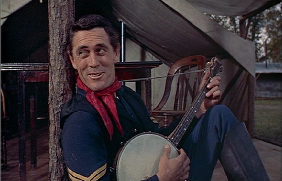

    @Cholla, could you attach a un-recoded clip of your video. I don't know if a "copy" can be done with FFMpeg but AVIDemux will do it, as per my guide here (first section).
    When we have a sample, we can advise.
    May 2005
    Australia-PAL Land
    My guesstimate is that it is around 1.56:1. I think the original head is a bit wide.

  3. @ Alwyn,
    I can make a snippet or sample with FFMPEG.
    What format would you prefer?
    I will make it from an original .VOB from the DVD that has not been encoded.
    I can even keep is in the .VOB format if that doesn't make the size too large to post.
    From your link the max size would be 500MB.

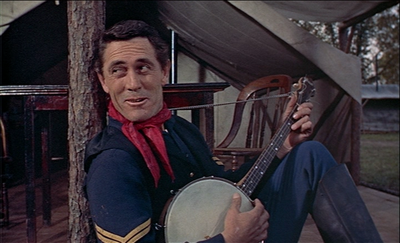

    I do not know if the images are 1.56:1 as MediaInfo reports 4:3 .
    I took the snap shots with VLC player & not screen shots with Windows.(As requested by hello_hello)
    I can see what another software I have reports the resolution as.
    May 2005
    Australia-PAL Land
    A short clip in MPEG 2 from one of the VOBs would be fine, Cholla. That will not entail a recode. Or if VOB is easier, we can all open those as well.
    Going only on your images, they are 4:3 because they include the top and bottom bars for a 720x540 1:1 frame size (720x480 displayed at 4:3).
    If I take away the bars, I don't come up with 16:9, but as mentioned in post #7, the active video area could be 14:9 (1.55:1), which was used in the past for some shows.

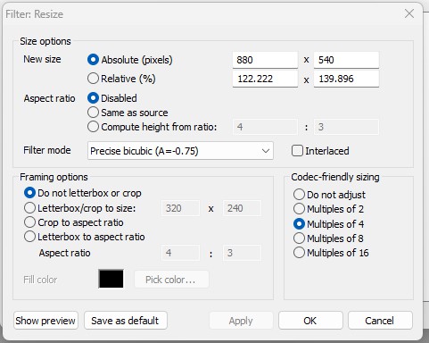

    Attached my 884x540 1:1 attempt. When you play it on a 16:9 screen, you'll have small bars on the sides.

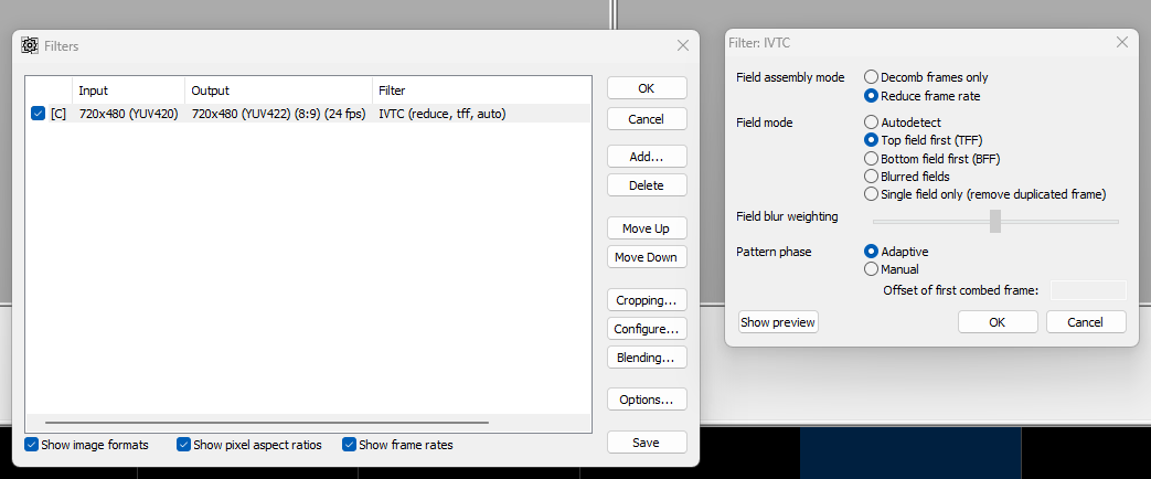

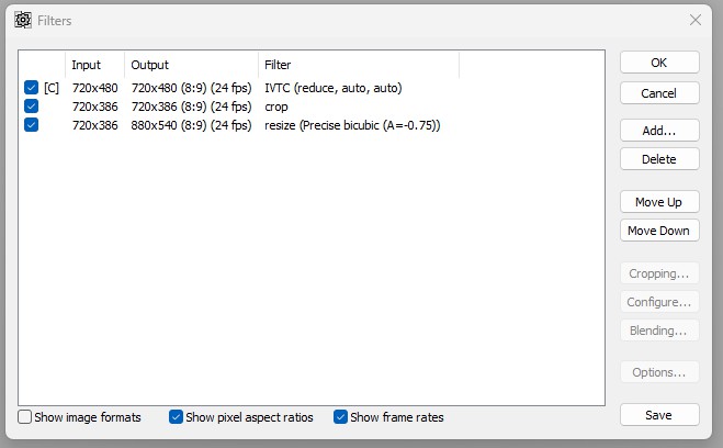

  15. For obtaining the 23.976fps progressive original film frames you can In VirtualDub2
    - open this Avisynth script
    v=ffms2("HORSE(01).vob",rffmode=0)
    a=LWLibavAudioSource("HORSE(01).vob")
    AudioDub(v,a)
    or:
    - open the .vob in Virtualdub2 directly and apply the IVTC filter like in the attached screenshot.
    and continue from there with cropping and resizing etc.
    Either method should work for recovering the orignal progressive film frames.

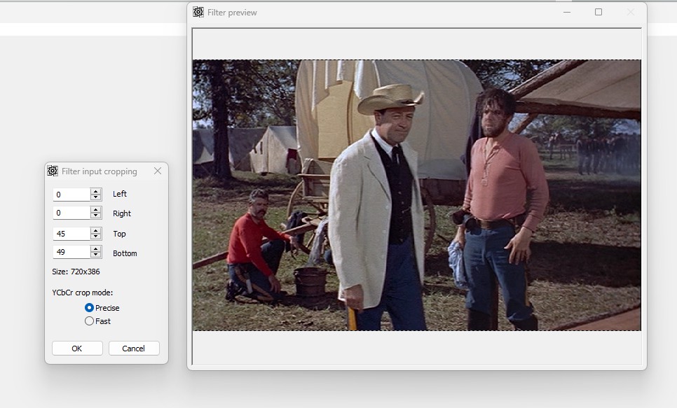

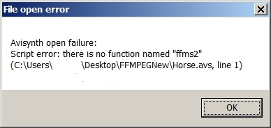

  17. I'm new to vdub so not sure I did the script method correct.
    I put it in a .text file & then changed the extension to .avs
    The second method allowed me to crop to the verticaldemensions I wanted so the scxreen is filled top & bottom.
    No horizontal strech though.
    This is the error I got from using the script:
    [Attachment 80282 - Click to enlarge]
  18. Yes, your script method is ok.
    Just install the ffms2 plugin in Avisynth
    http://avisynth.nl/index.php/FFmpegSource
    https://github.com/FFMS/ffms2/releases

    @Sharc, excellent, thanks for the VDub settings. Works well, seems to be the same quality output as using TIVTC (TFM/TDec) in AVIsynth.

    Here are my VDub2 filter settings. The IVTC is as per @Sharc's above.
    [Attachment 80286 - Click to enlarge]
    [Attachment 80287 - Click to enlarge]
    [Attachment 80288 - Click to enlarge]
    My VDub attempt attached.

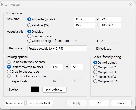

  25. Note that not all TVs/players will play non-standard frame dimensions / Aspect ratios correctly. So it is generally safer to resize and pad to a standard resolution like 1280x720 for example.
    v=ffms2("HORSE(01).vob")
    AudioDub(v,a)
    Crop(0, 44, -0, -48)
    spline36resize(1188,720) #square pixels
    addborders(46,0,46,0)  #padding to 1280x720

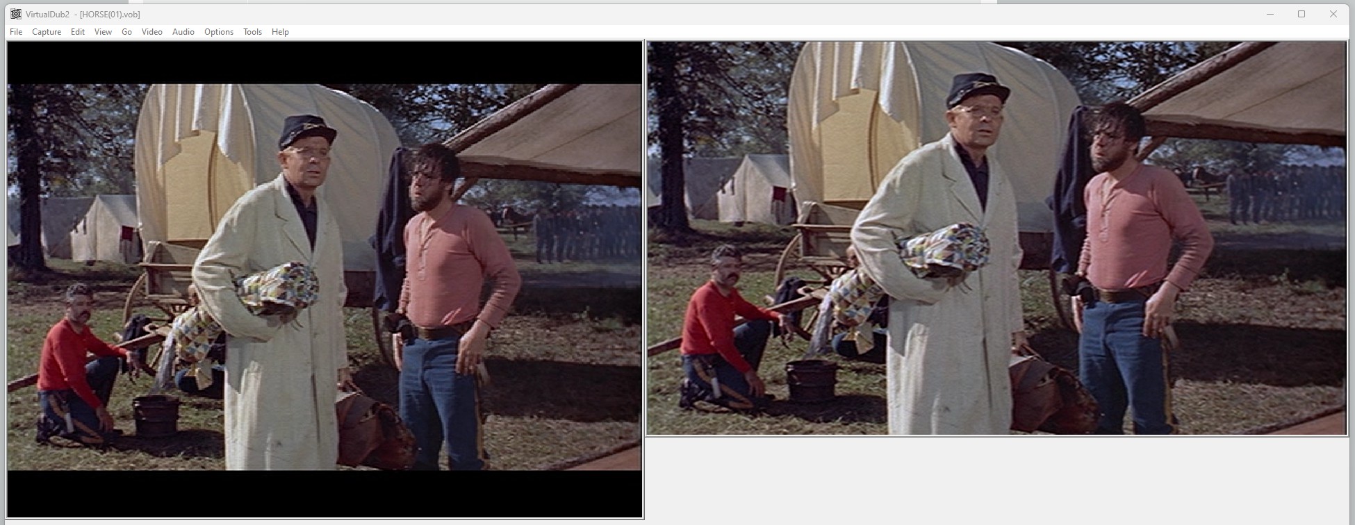

    Pillarboxing in VDub2:
    [Attachment 80300 - Click to enlarge]
    It would pay to trial the non-padded file; padding reduces the visual size on any 4:3 screen (ipads) or a phone held upright. I haven't come across a player or TV that can't/won't properly display a file such as this. In any case, there should be a control to change the view so that it fits vertically without stretching horizontally.

  28. Your video has duplicted frames to make it 30fps and so it has judder. Step through the frames and you will see the duplicates in a pattern like abcddefghh..... You should decimate it and play it at 24fps (23.976fps).
    You cropped slightly into the picture vertically and stretched it horizontally (about 5%) with your example in order to fit the 1.65 movie into 16:9 (=1.7778) without pillarboxes. Means the picture is slighly distorted. But if you like it that way .....

    Originally Posted by Cholla
    I tried both of the last videos posted by Alwyn & Sharc they looked fine but still pillarboxed.
    By design. The video isn't a 16:9 video; it's more like 16:10, so to preserve the correct shape, it should have pillarbox bars. That said, there's not a lot in it so it's your choice to stretch it to 16:9.
    If you don't want pillarboxing, change the VDub resize to this:
    [Attachment 80312 - Click to enlarge]
    You can see the slight stretch distortion (wider heads) when you compare the original and the 1920x1080 version:
    [Attachment 80316 - Click to enlarge]
    1920x1080 version attached.
