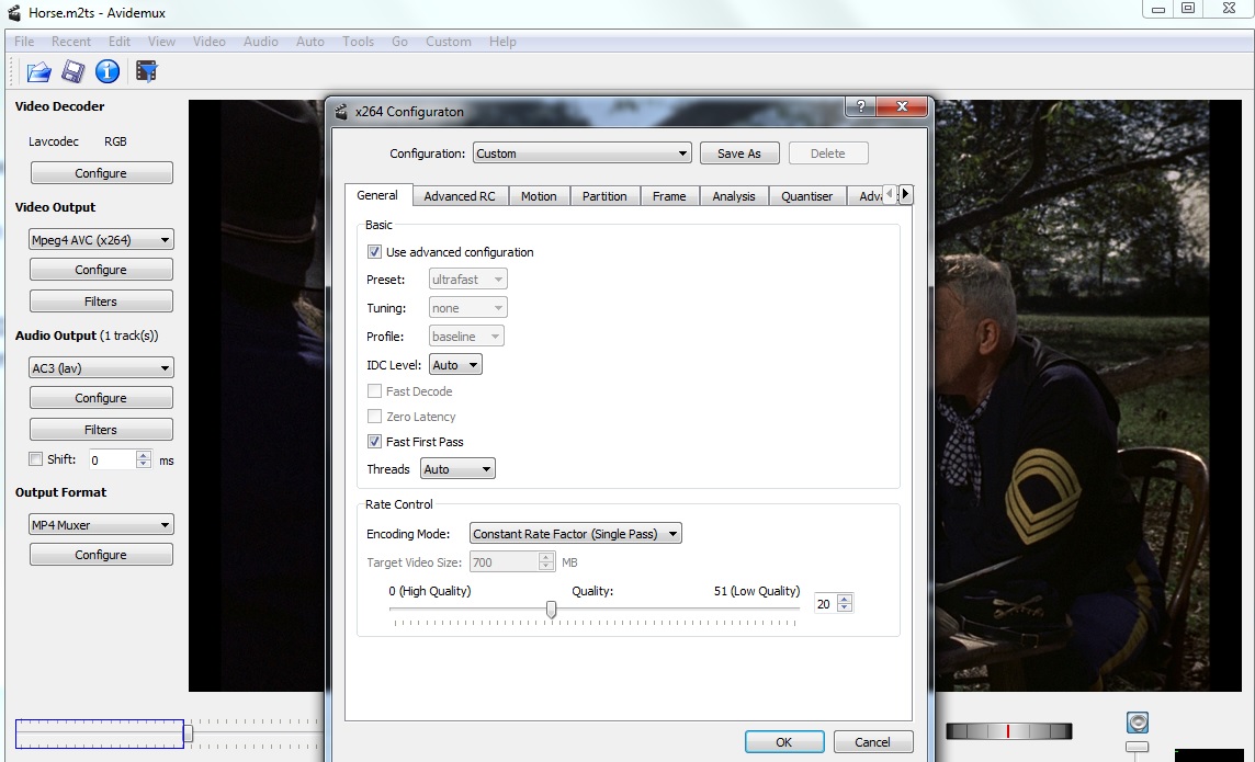

 Horse2.mp4 was done with the settings like in the image.
 Except "Fast first pass" was unchecked.
 [Attachment 81413 - Click to enlarge]Last edited by cholla; 11th Aug 2024 at 18:51.

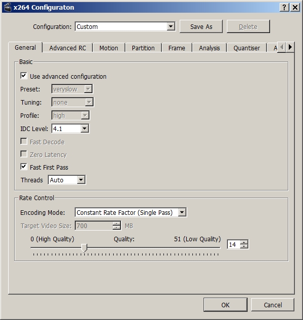

	@DB83,
 Other that the higher quality settings I made on the "General" tab>(& I tried with the exact settings Sharc posted in #329 the first time).
 I made the settings in the other tabs exactly as Sharc posted.
 I believe those changes are what made the green artifacts go away.
