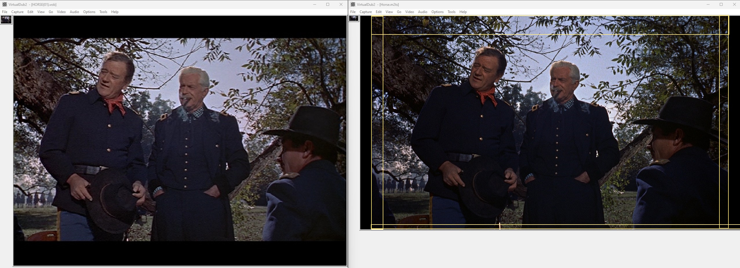

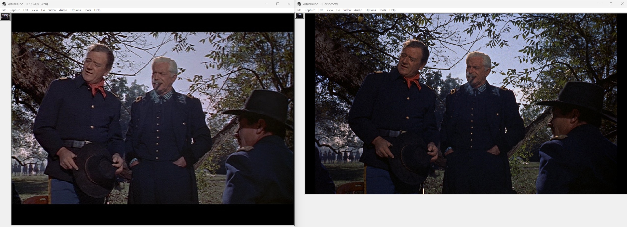

    There are noticeable differences between the 4:3 VOB and the 16:9 bluray:
    -the bluray looks to be stretched laterally: the heads are wider;
    -the bluray does have more noise (interestingly, the online version, otherwise the same as the bluray, sems to have less noise);
    -the bluray brightness levels much darker with almost no detail in the darker areas (blue of coat) and the faces are too dark/well tanned ;
    -the colours of the bluray are nicer/more saturated;
    -the bluray is sharper (as one would expect at the higher resolution).
    -the bluray is the same, structurally-speaking, as the file on m4uhdtv.

  10. ^^
    ... the blu-ray has more active picture content on all sides (left/top/right/bottom).
    Added:
    Taking your (Alwyn's) screenshot above (or inspecting the originals): additional picture content marked yellow in the blu-ray version.
Name:	VOB vs BLuray_Alw.jpg

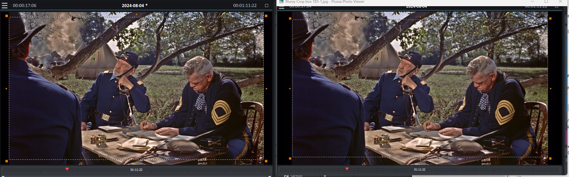

    And now you have the bluray, you can crop away the side bars. There would be no point in cropping to 1.85:1; you retain more of the picture cropping to 16:9.
    16:9 on the left, 1.85:1 on the right:
    [Attachment 81191 - Click to enlarge]
    It also denoises nicely; I used Neat Video but I'm sure the freebies will do a good job too. The more you notice it, the noise is bad, obvious even on the coats.
    PS: Not that I am suggesting you do any cropping!

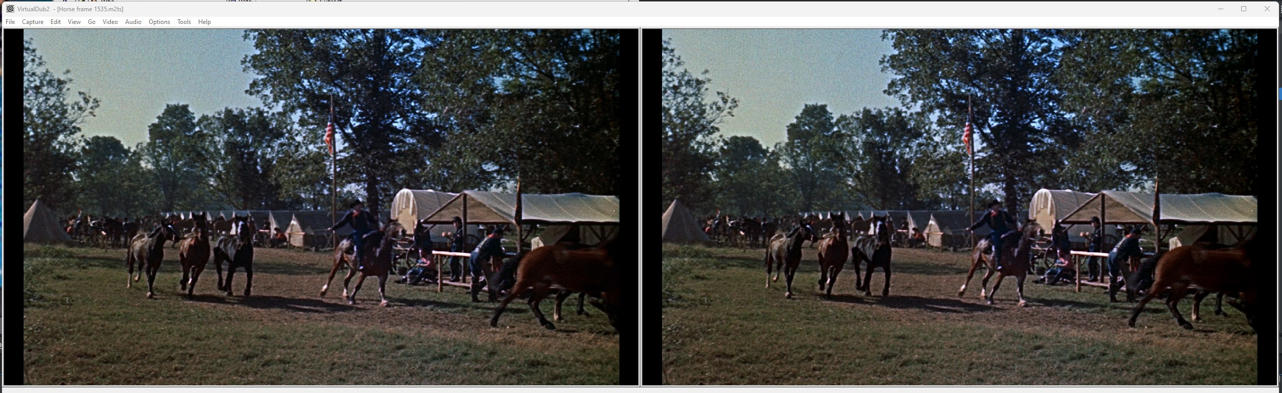

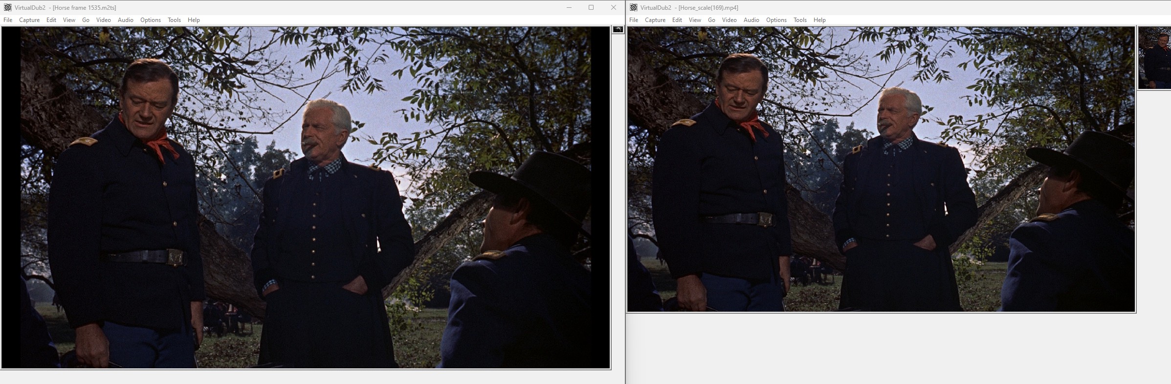

    @Cholla, you're distorting the video. On the left is the Horse m2ts file you posted from the Bluray (ignore the "frame 1535"); on the right is your latest Horse_scale(169).mp4. Check out John Wayne's head.
    [Attachment 81228 - Click to enlarge]
  17. Originally Posted by Alwyn View Post
    He knows that. He just doesn't care. He's obsessed with filling the TV screen, no matter the cost.

    Alwyn, I looked at it again, I agree, it's more subtle than I thought last time, the Vdub filter softens it slightly which
    appears to lower the grain slightly. Whether it's worth the trouble is not up to me.
    Using Temporaldegrain2 in Avisynth gets rid of all the grain at a default settings; it can be tweaked to
    temper the effect but it's so slow (on my old PC anyway)
    The other benefit of Avisynth is that it keeps it in the yuv(yv12) color space; no need for the RGB conversion from the vdub filter.

    To me this is just larger frame equals larger image. So of course John Wayne's head is larger.
    No, the heads are obviously FATTER/WIDER than they should be. It appears that what you/ffmpeg have done is simply cropped off the pillars then stretched the 1.66:1 video into the 1.77777 (16:9) frame.
