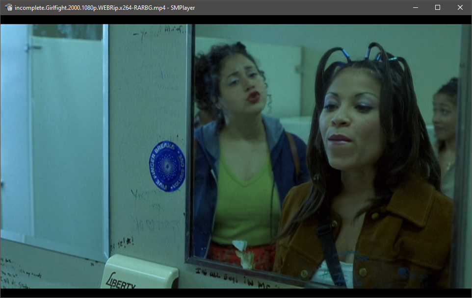

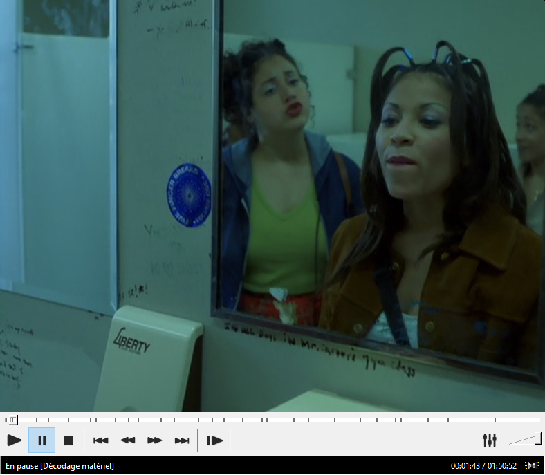

    Girlfight A/R problems :
    1°) DVD folder with media players render correct 1.85:1 A/R (16/9 with tiny black bands).
    2°) Extracted .m2v video stream with MeGui, recreated index on .m2v, as usual :
    3°)
    Index from VDub (.midx) with .m2v, displays correct A/R (declares 1.422:1), exports 4/3.
    Avidemux opens DVD folder in 4/3 (info says PAL 16/9), exports wider than original source.
    .avs script with .d2v in VDub declares unknown A/R, and exports in 4/3.
    I will certainly need an AVS thing to fix A/R issue.
    Sample and files :
    Sorry, sample from Avidemux !! EDIT : OK, MPCbe shows wider frames o my other computer !!
    https://drive.google.com/file/d/1kePuaINaegnT0v_t_5SPN-goXSovgz2e/view?usp=sharing
    DVDPlayer (real A/R)
    [Attachment 56534 - Click to enlarge]
    Attached files ++
    EDIT 3 : i don't see interlace at all. In that case i'd use direct DVD files with Handbrake.
    Kind of DVD that comes with two A/R !!
    https://www.dvdempire.com/24110/girlfight-movie.html
    This one says : Aspect Ratio: Full Frame - 1.33 :
    https://www.oldies.com/product-view/79716M.html
    I prefer full frame aka 4/3, why i can't choose when ripping DVD ? 1.85:1 compatible 4/3 is written on the box, better write nothing, is there DVDs not compatible 4/3 ?
    Tue fullframe DivX is good quality, i'll put french AC3 on it !
    [Attachment 56535 - Click to enlarge]
    [Attachment 56536 - Click to enlarge]

    DVDs PAL (16:9 crop) & NTSC (fullframe), GirlFight has VFQ but i "want" (need) VFF from the PAL source, problem, i'll have to sync audio because :
    Frames & times async :
    VFQ (NTSC)
    1:23.458
    1:42:50.081
    @24 fps (AVS VDub) :
    1:23.375
    1:42:43.917
    VFF (PAL)
    @23.976 fps (AVS VDub) :
    1:25.711
    1:42:50.289
    1:25.625
    1:42:44.125
    I don't have audio tools apart UseEac3To, i know Audacity can do it, do i need it ?

    Hello everybody,
    i now use MakeMKV and watch DVD's w/o pre-deinterlace them (except H), and thanks to you i learned to use AviSynth........... thanks again.
    i had luck and found a VFF (4:3 fullframe DVD was VFQ, Z1 import) audio from a 16:9 HD source (certainly from TV) that syncs exactly, now i have the fullframe movie, in TrueFrench.
    Lucky because :
    i never ended to find the way to sync audio to async videos myself, and that's what i search to do now for Suspiria, the US is correctly remastered but the PAL is like a colorish pizza (not the Italian type, but like those found in the freezer, also blue became green, and gray also, ...), that's Bluray sources, i want to sync French audio, that's the times i found for same frames along the movie :
    VFF (bad picture)
    US (verry good)
    first image (after logo black frames)
    1:26.708
    1:29.673
    7:05.000
    7:08.303
    20:54.000
    20:58.132
    34:58.083
    35:03.101
    48:33.667
    48:39.500
    1:16:29.208
    1:16:36.717
    1:30:16.542
    1:30:24.878
    movie end (last scene)
    1:37:02.583
    1:37:11.326
    HEEELLLPPPP
