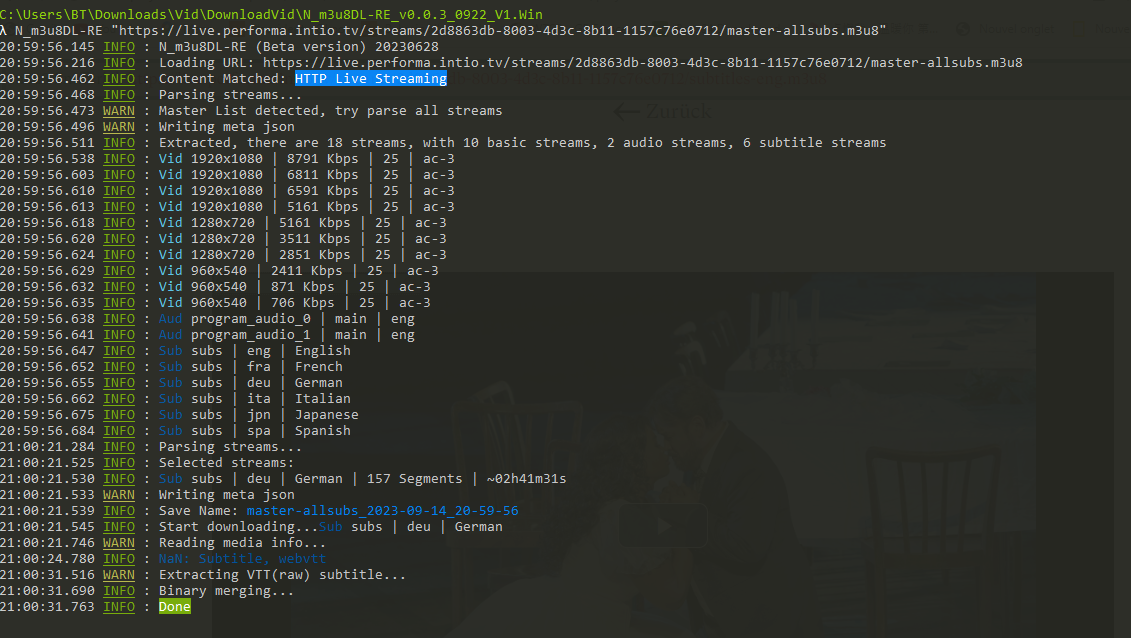

  2. youtube-dl --hls-prefer-native "https://live.performa.intio.tv/media/dc78f33f-142d-427a-8249-e38c111ed032/subs-deu.m3u8" -o sub.vtt

  8. For 'Raymonda':
    youtube-dl -f bestvideo+bestaudio "https://live.performa.intio.tv/streams/fc6c896f-f27d-4347-972d-5155368bd998/hls.m3u8"
  9. This should work for first Sylvia
    youtube-dl.exe -f bestvideo+bestaudio "https://live.performa.intio.tv/streams/V_FRA_PROD_SYLVIA/hls.m3u8"

    Download ytdlp, put in folder, open cmd in that folder, run this code
    ytdlp.exe "https://live.performa.intio.tv/media/bd5bdfb0-8290-4afd-9a20-56c52f6283a6/hls_audio_2_96_25.m3u8" -o vienaaudio.mp4
    then use ffmpeg to merge your video with the audio
    ffmpeg -i videoname.mp4 -i vienaaudio.mp4 -c copy vienafinal.mp4

  22. yt-dlp --write-subs --sub-langs eng --skip-download https://live.performa.intio.tv/streams/e3079b7b-6806-4124-bb81-2c1ec9fbfaa0/hls.m3u8
    [generic] hls: Requesting header
    [generic] hls: Downloading m3u8 information
    [info] hls: Downloading 1 format(s): 6485+program_audio_0-Alternate_Audio
    [info] Writing video subtitles to: hls [hls].eng.vtt
    [hlsnative] Downloading m3u8 manifest
    [hlsnative] Total fragments: 2002
    [download] Destination: hls [hls].eng.vtt
    [download] 1.7% of ~107.53KiB at 211.41B/s ETA 10:17 (frag 35/2002) ...
