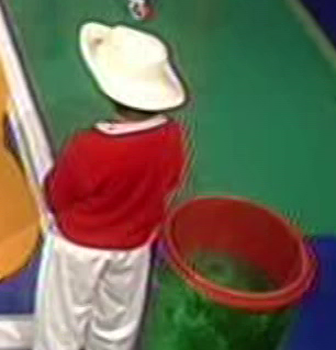

  10. I tried adding AssumeFPS(25) before QTGMC, whilst using LSMASH and that seems to have sorted it. Just hope i didn't throw away half the fields by doing so? But video seems to run smoothly after render. My only concern is stated runtime has doubled.
    Also, I believe MosquitoNR only works properly on progressive frames. ChubbyRain2 can work with interlaced frames but you must specify interlaced. I've moved the around but comment them out since I don't have them and they're not germane to the original jerky video problem. Actually, MosquitoNR appears to be available in a 64 bit version so I don't see the need for MP_Pipeline at all -- you might just have to specify the multithreading mode.
    Oh i see, that must explain why it hasn't been really effective. Curiously when i add MosquitoNR after QTGMC it causes AvsPmod to crash! So it must not play nice with the the 64 bit version. Hopefully there's something else that can remove whatever these artifacts are. Dotcrawl? It's more apparent on red.
    [Attachment 55794 - Click to enlarge]
    Also how do you specify interlaced for ChubbyRain2?
