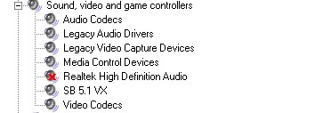

    In the end I installed SB5.1 card from my previous setup. This is working fine. I uninstalled Realtek to get rid of that fancy thing from the tray but it came back again next boot. So I have disabled it. Does anyone know if it's needed ? Or how to exclude it from Device Manager ? I now have the following (if someone advises if not ok)

  12. I'm a Super Moderator johns0's Avatar
    canada
    Go into your motherboard bios and disable the onboard sound,it will keep coming back unless you do that.
    Jun 2012
    New Zealand
    Thanks muchly johns0 that sorted it nicely. I should have known to do that - but thought all the onboard stuff was disabled when a sound card was plugged in !
