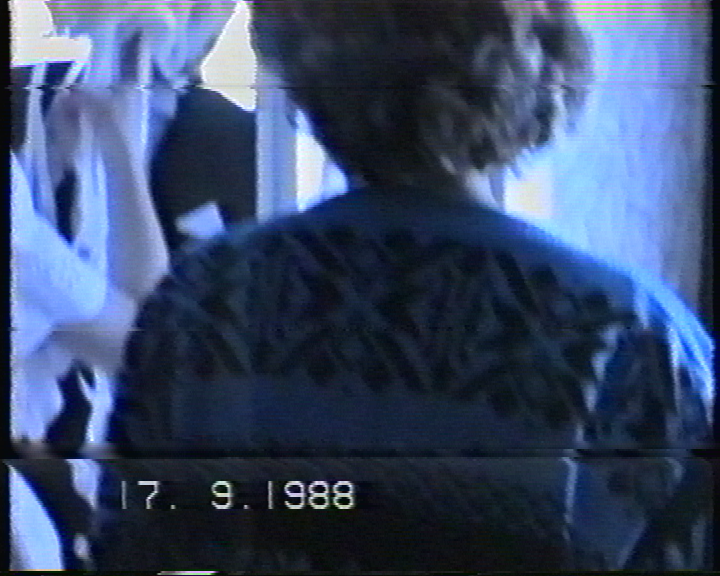

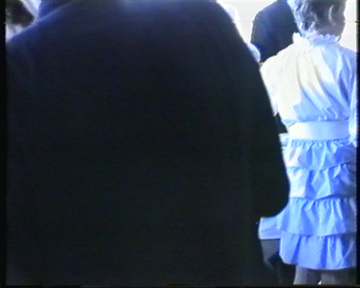

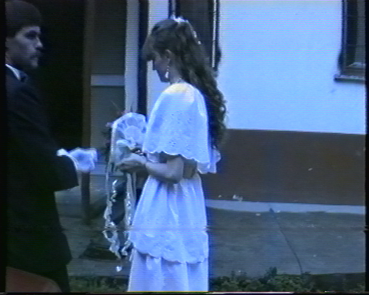

I'm trying to digitize a couple of home recordings using my old JVC HR-S6722 Video Recoder and S-VHS cable and the picture has horizontal lines across entire video. Could you tell if it's an issue with the tape itself of could it be connected to hardware related problem?

Those are Hanover bars. You can blur them away. Some capture devices do that while capturing, others don't.
On a side note, those deep artifacts, like the one above the number 1988 are usually from actual linear damage to the tape. Often times from crap getting on the guide posts and scratching a length of tape. Nothing can really be done about that.
A close look reveals those might not be Hanover bars. There's something in the luma channel as well. That might be an issue with the way you made sample images though. A raw video sample would be more helpful.
jagabo: Thanks for the reply. The footage indeed looks better after running the ChromaDestripe function. I've edited the post with the exported RAW sample.
KarMa: It's definitely that. The tape has been played by almost everyone in the family and there's no chance that it was even stored properly.
flashandpan007: All I was thinking about were the horizontal lines... I don't know why gave the title about "the vertical ones" -
