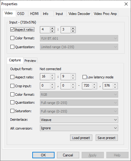

    My capture card is a Magewell Pro Capture HDMI, and i'm capturing via S-VIdeo
    If I open VirtualDub2, and go to the Capture AVI mode, and open Video->Capture filter, I see the following:
    [Attachment 55752 - Click to enlarge]
    The 720x576i on the Input box, and also in the "Crop input" box are on 720x576 regardless of the resolution I actually pick to capture at.

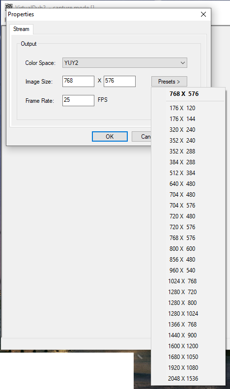

    Onto resolutions. If I click on Video->Capture Pin, I have a bunch of presets I can pick from. The default (in bold at the top 768x576) is in bold regardless of what resolution i've picked from, but as you can see, I have plenty of options available:
    [Attachment 55753 - Click to enlarge]
    The image is stretched/shrunk to match whatever resolution I pick, it does not crop. I.e. if I picked 1280x720, a 4:3 video would look streched.

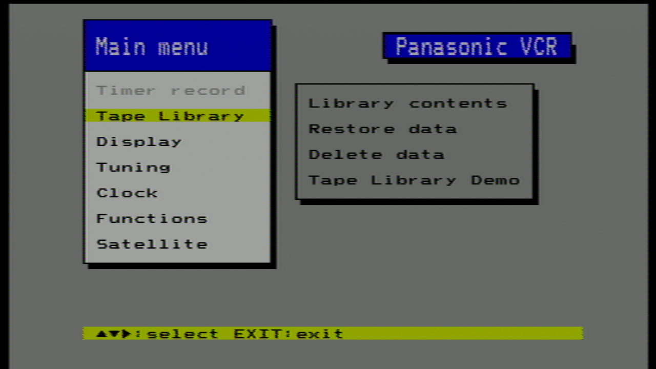

    I've done captures at the following resolutions: 704x576, 720x576, 768x576, 788x576 & 1280x720. Here are screenshots of all
    [Attachment 55754 - Click to enlarge]
    [Attachment 55755 - Click to enlarge]
    [Attachment 55756 - Click to enlarge]
    [Attachment 55757 - Click to enlarge]
    [Attachment 55758 - Click to enlarge]
    Is this what people were expecting? I get the impression people were thinking that by expanding the horizontal resolution, i'd end up with the same proportioned image in the centre, just more black pixels either side, which is not the case.

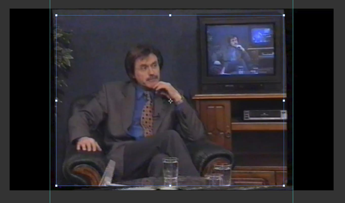

    If I take the 720x576 image, crop the sides to 702x576, then expand that to 768x576, the image looks identical to if I took the 788x576 image and cropped the sides to 768x576. However the latter image is of a superior quality, presumably because i haven't need to stretch the image further after capturing.

    I've found some reference images and if I leave the black bars in there and stretch to 768, it's still squashed, whereas cropping to 704 and then stretching to 768, the images are in proportion, so thanks all! Kinda wish I could crop by 9 pixels on one side and 7 on the other, but avisynth wont let me, oh well.

  23. Originally Posted by bergqvistjl View Post
    You can do this with the resize filters' built in cropping values. For example:
    Spline36Resize(768,576, 9, 0, 704, 576) # output width, output height, source left, source top, source width, source height
    You could also do it by converting to RGB or YV24, cropping, then back to YV12:
    ConvertToYV24()
    Crop(9,0,-7,-0) # or Crop(0,0,704,576)
    ConvertToYV12()
  24. Capturing Memories dellsam34's Avatar
    Jan 2016
    The cropping in script is trial and error since you don't have a way to monitor the edges you're cropping off that's why vdub is very handy.
  25. I get my "source" material from a 3rd party which I have no control over, VHS digitized with who knows what device, as 720p. I need to transcode this to a selfhosted video delivery platform (web). I decided to just use square pixels to avoid the mess, output is in mp4, RF 20 x264, 768x576 at whatever FPS my original is at (it's supposed to be PAL but my source says 29.97, go figure - not sure if I should slow that down?). I took a screenshot from my player, applied a 4:3 selection in photoshop and it nicely covered the video frame. In handbrake I crop 160 from left and right, then downscale that to my output res. I have black bars within that but if I were to crop a few seemingly random amounts more from each side while maintaining the 4:3, I'd chop off useful data from some sides, since the atrocious quality of VHS. Some sides are curved
    [Attachment 60750 - Click to enlarge]
    I guess if I don't mess with the cropping, the output will have a more nostalgic feel to it and it'll be clear this is from a VHS and people maybe will just accept that. Either that or I'm butchering this even more by discarding useful data (top left and bottom right)
