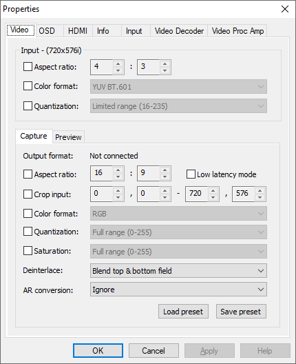

    I notice the properties in the "Capture Filter" option in VirtualDub say 720x576, yet the default resolution it wants to output is 768x576
    [Attachment 55741 - Click to enlarge]

    I do not know where that above graphic comes from but it is certainly not from vdub.
    You do appear to be confused with pixel aspect ratio and display aspect ratio. And both will vary according to what codec you capture in. For a start, most AVI containers do not support a valid DAR.

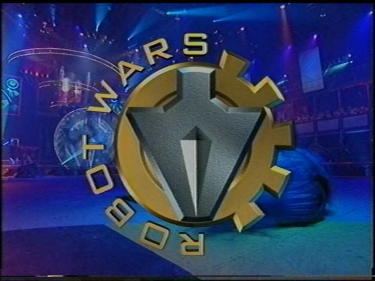

    Anyway, here is the raw image captured at 768x576, with no post-processing/cropping/resizing at all.
    [Attachment 55744 - Click to enlarge]
    and here is the same image captured 720x576, cropped to 704x576 then stretched again to 768x576
    [Attachment 55745 - Click to enlarge]
    which is the correct one?

    The 2nd one since it removes the crud (16 pixels)
    And you do not upscale. You resize. That compensates for the non 4:3 704*576. No need for the intermediate 768*576 except for your own purposes rather that the upload. Resizing from the 704 >> 768 involves two re-encodes.
