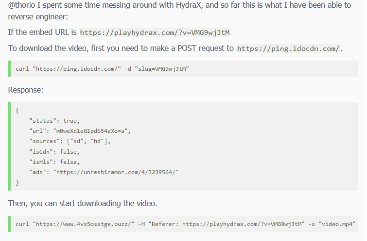

    so i found a way on github
    here: https://github.com/thorio/KGrabber/issues/35
    [Attachment 55743 - Click to enlarge]
    if you want to open developers tool inside chrome use this extension: http://shorturl.at/tLSY5
    okay it worked on hydrax.net here is ss: https://imgur.com/ZUNPLWt

    E:\curl-7.73.0_1-win64-mingw\curl-7.73.0-win64-mingw\bin>curl "https://ping.iamc
    dn.net/" -d "slug=pv4XvdNMPN"
    {"status":true,"url":"2Z2MHZvbno2ci5tb25zdGVyN","s ources":["sd"],"isCdn":true,"i
    sDownload":false,"ads":"https://www.passtechusa.com/xy0nbeva?key=e551d7f6bdf2dd6
    eb646c02b63428335"}
    E:\curl-7.73.0_1-win64-mingw\curl-7.73.0-win64-mingw\bin>curl "7fv0vonz6r.monste
    r" -H "Referer: https://playhydrax.com/?v=pv4XvdNMPN" -o "test.mp4"

  4. curl "https://7fv0vonz6r.monster" -e "https://playhydrax.com/?v=pv4XvdNMPN" -o video.ts
    Hi LZAA, thanks for your info, i'm use -k -e and it's worked !
    E:\curl-7.73.0_1-win64-mingw\curl-7.73.0-win64-mingw\bin>curl "https://7fv0vonz6

    E:\curl-7.73.0_1-win64-mingw\curl-7.73.0-win64-mingw\bin>curl -k "https://7fv0vo
    % Total % Received % Xferd Average Speed Time Time Time Current
    Dload Upload Total Spent Left Speed
    100 138M 100 138M 0 0 794k 0 0:02:58 0:02:58 --:--:-- 472k
    Thank all for help this issue.........
