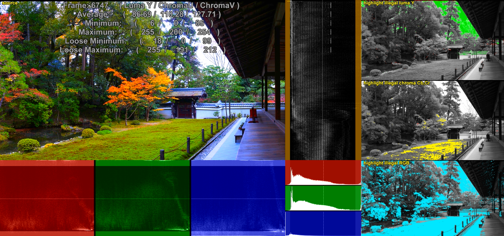

	So here comes a new variant to try.
 The bottom shows the RGB waveforms which provide additional info as to which components (R,G,B) exceed the legal range.
 The script is based on scripts from this forum as discussed before, and from Avisynth/doom9. I hope I did not mess these up too much
 [Attachment 55799 - Click to enlarge]
