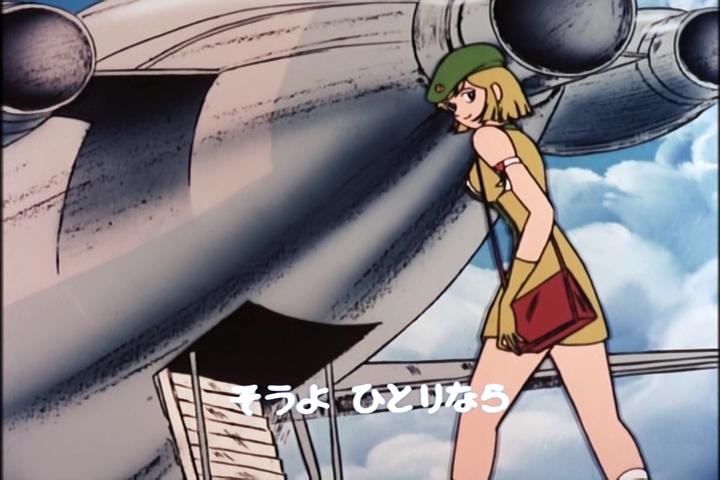

  5. Here's one shot that appears in your sample images, adjusted to be fairly close:
    [Attachment 55700 - Click to enlarge]
  6. Member Troc's Avatar
    Oct 2020
    Finland
    That could work. What parameters did you use? I'll have to replicate all through the project.
