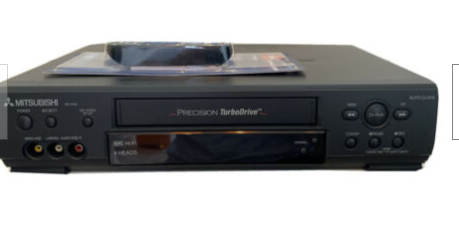

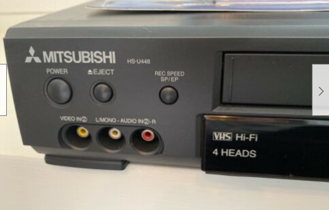

  16. The Tape Speed is SP i was wondering if the picture i sent the right Mitsubishi VCR
Name:	Mitsubishi Picture.PNG
Name:	Mitsubishi Picture 2.PNG
  17. Originally Posted by orsetto View Post
    Since you've confirmed the problem persists across three different VCRs, is not significantly relieved by switching from HiFi to normal soundtrack, and all your other tapes play properly, the issue is in this specific tape and not your VCRs.
    I totally agree. The OP has a bad tape, and there is nothing that person can do about it, other than to try to adjust the volume in an editing program.
  18. Originally Posted by battybarney View Post
    Yes, thats the one I own and have recommended to others here for problems similar to yours.
    But I'm not sure it would be worth buying just to transfer this one tape, since the episode is available from other sources at far less cost than a VCR? Remember, if the tape is really far off spec, its possible no VCR will be able to lock steadily on the HiFi.
