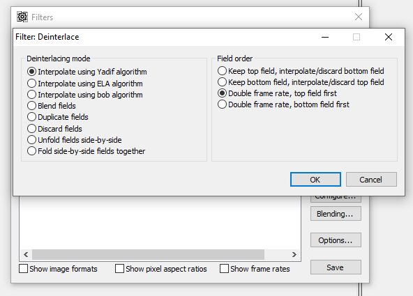

    So I opened the giant mkv file in Virtualdub2 and noticed that the video was interlaced. I applied a YADIF de-interlace filter and separated the fields into their own frames. This straight away turned my mkv file from 25fps to 50fps. I then proceeded to manually break the episodes up into their own individual files and save each one as an avi using utvideo lossless codec.
    You probably ruined them by applying Yadif to deinterlace and bob (double the framerate). Once degraded like that, the rest of your workflow is useless.
    Ruined? How so? After I applied the filter in VirtualDub2, it not only fixed the de-interlace issue but it also made the video MUCH smoother.

    This is very interesting. When I imported the .mkv that MakeMKV spat out into VirtualDub2, this is the exact de-interlace setting I used. - I used no deinterlace settings within Handbrake at all when compressing to H265.
    [Attachment 55683 - Click to enlarge]
    I'm going to assume based on what you said, this was the wrong move.
