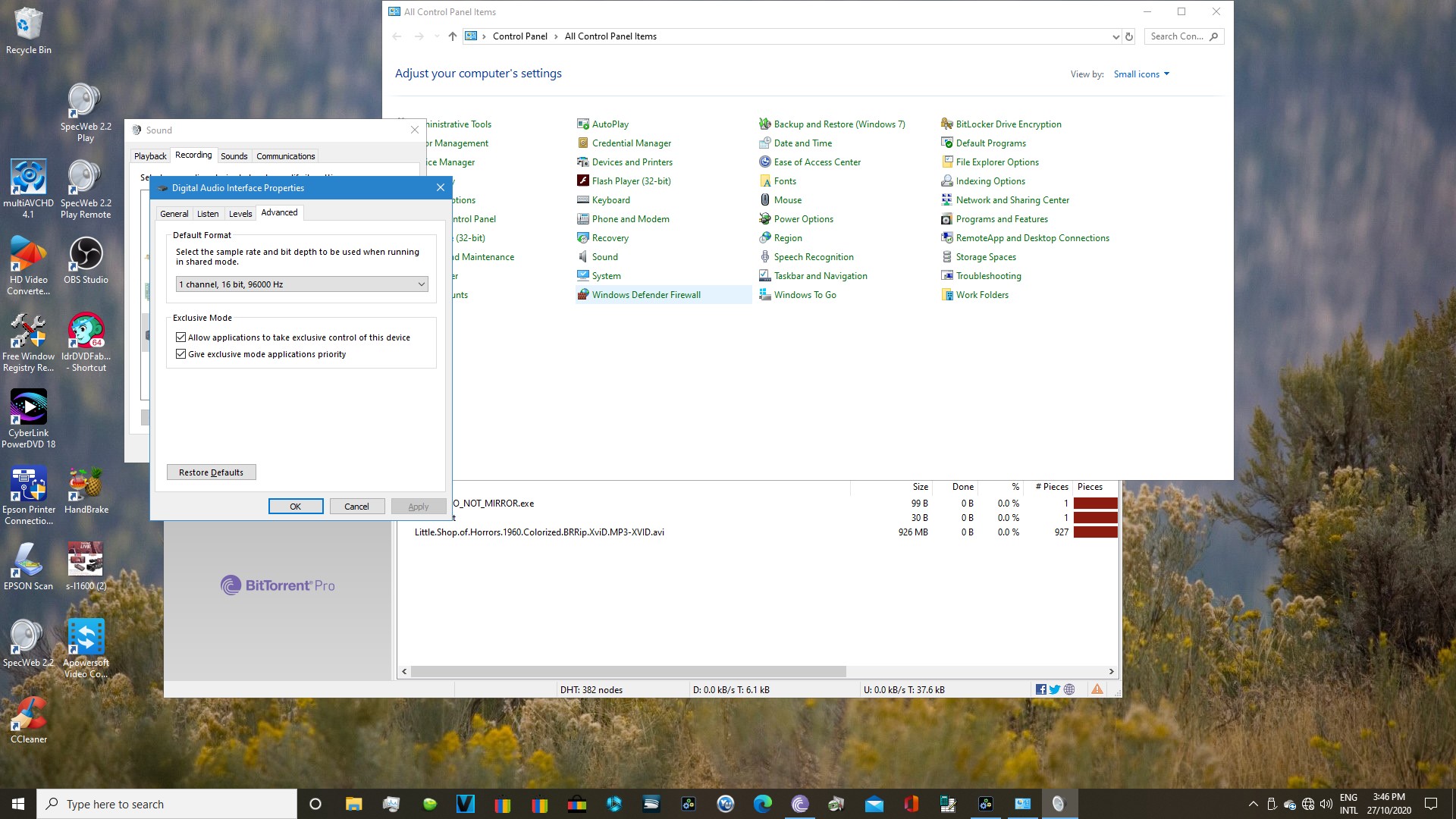

    adding a couple of shots of the driver manager
    it apears i have two sets of sound devices \
    [Attachment 55656 - Click to enlarge]
    [Attachment 55657 - Click to enlarge]
Name:	Screenshot 2020-10-27 154616.jpg
Name:	Screenshot 2020-10-27 155458.jpg
    May 2012
    adelaide
    wrong photos these are from a hdmi grabber that showse wrong frequeccy it should be 48KHZ
    will put up correct photos

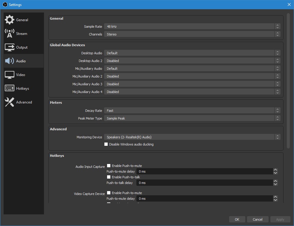

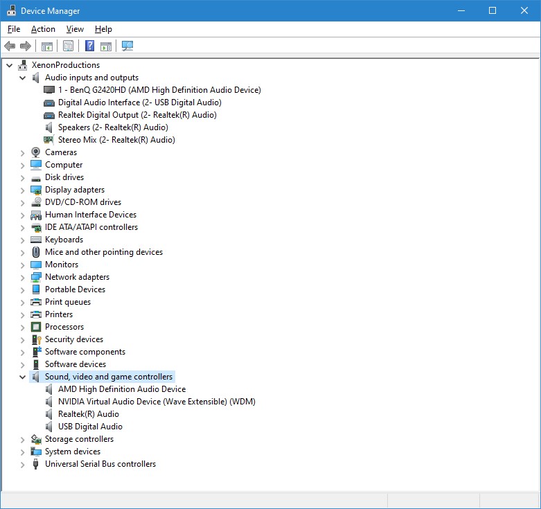

    [Attachment 55658 - Click to enlarge]
    its ok now i have remove heap of duplication item in thos areas
