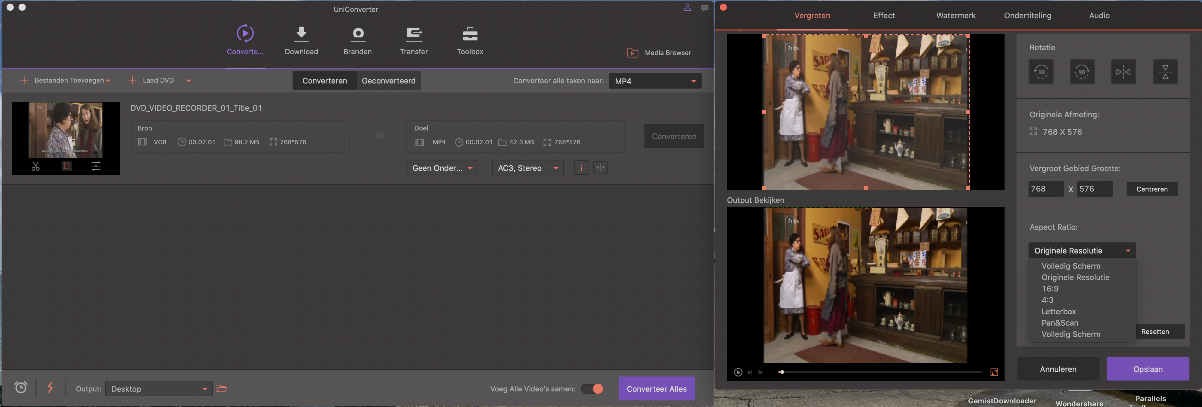

    [Attachment 55675 - Click to enlarge]
    In this screen normally I can make changes in the aspect ratio.
    Sorry, it's a Dutch UniConverter...
    My DVD recorder seems to store it in 768x576. 4:3 format, right?
    In the upper picture you see an orange rectangle. You can make it smaller, but it's not possible to stretch it. I've already had similar situations were I stretch the rectangle to 16:9 and the output gives a correct 16:9 picture. For one stupid reason, it's not possible to stretch this.
    In the flip down menu under Aspect Ratio, you can choose between 16:9; 4:3, pan&scan etc... In this movie file doesn't do a change to this nothing.
    About your question: I can do this, but it doesn't give any result.

    In UniConverter I always used the option: Convert all tasks to: original resolution. I switched this over to MP4 720P. With this setting and after selecting 16:9 in the Aspect ratio drop down menu black bars are away!
