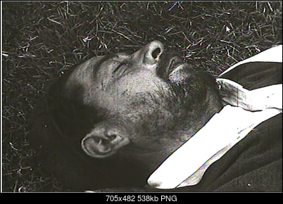

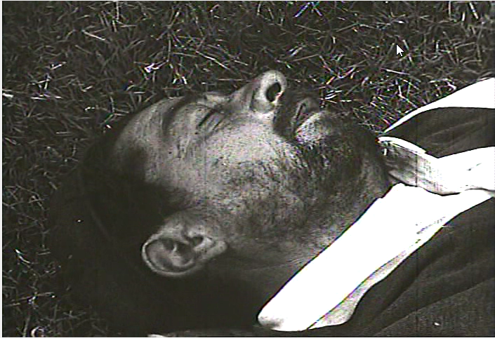

  1. If I'm encoding some material shot in black and white, usually greyscale() does a good job of removing those annoying color artifacts. But in this case I feel greyscale() is changing the tint too much: Original color,
    [Attachment 55607 - Click to enlarge]
    Greyscaled,
    [Attachment 55608 - Click to enlarge]
    I know it's subjective, but I feel the latter has become bluish. How can I keep the same black and white feel of the original while making sure all those color artifacts are gone, and without changing the tint too much?

    If you open these images in a image editor and use the eye dropper you'll see that the original is too red in the mid greys (white and black are okay). The greyscaled image is perfect across all levels. The only way you might be able to do this in a good video editor where you might be able to add back some tint.
  3. If Grey scale looks bluish then IT means that you have badly calibrated monitor. (Too cold color temperature set)

  4. Your original is sepia color, it's not clear what you mean by color artifacts. A grayscale function removes tint (by nulling YUV chroma, or by applying a custom LumaCoeff in RGB), but you can reapply tint if you wish and as you wish.
    https://forum.doom9.org/showthread.php?p=1925869#post1925869
  5. Interestingly your grayscale image has a pattern of periodic holes in the histogram, maybe try a different grayscale function that avoids this issue.
  6. You can make the image greyscale then add back the chroma offsets. That won't be prefect because the offsets vary by intensity but it might be close enough for you. ColorYUV(cont_u=-256, cont_v=-256).ColorYUV(off_u=-3, off_v=3). You could get a close match buy using masks to apply different offsets to different intensities.

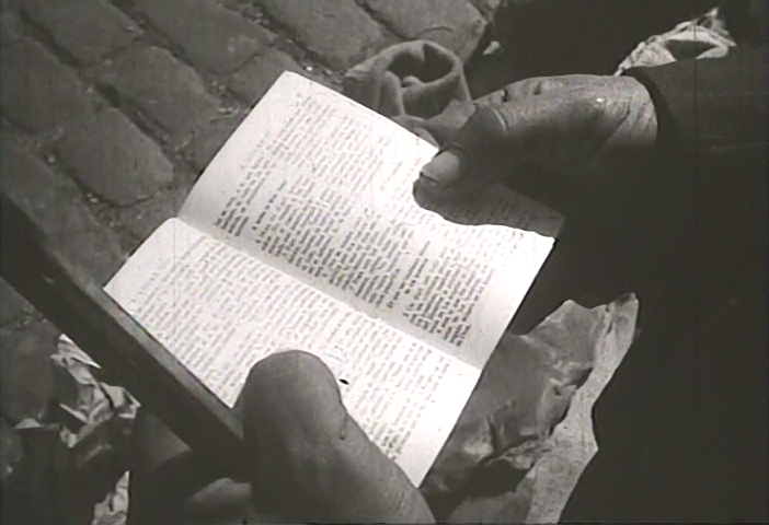

  7. Thank you all for the comments. Here's a picture of the color artifacts:
    and a short snippet: https://www.sendspace.com/file/7llsdy
    Jagabo's ColorYUV line has very good effects (I don't know what it does precisely; I'll try to understand it from the manual pages but if you want to help with a tl;dr I won't complain!). The MergeChroma one reduces the rainbows but doesn't get rid of them entirely.
