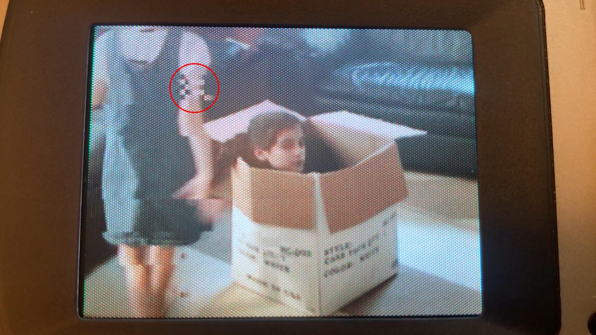

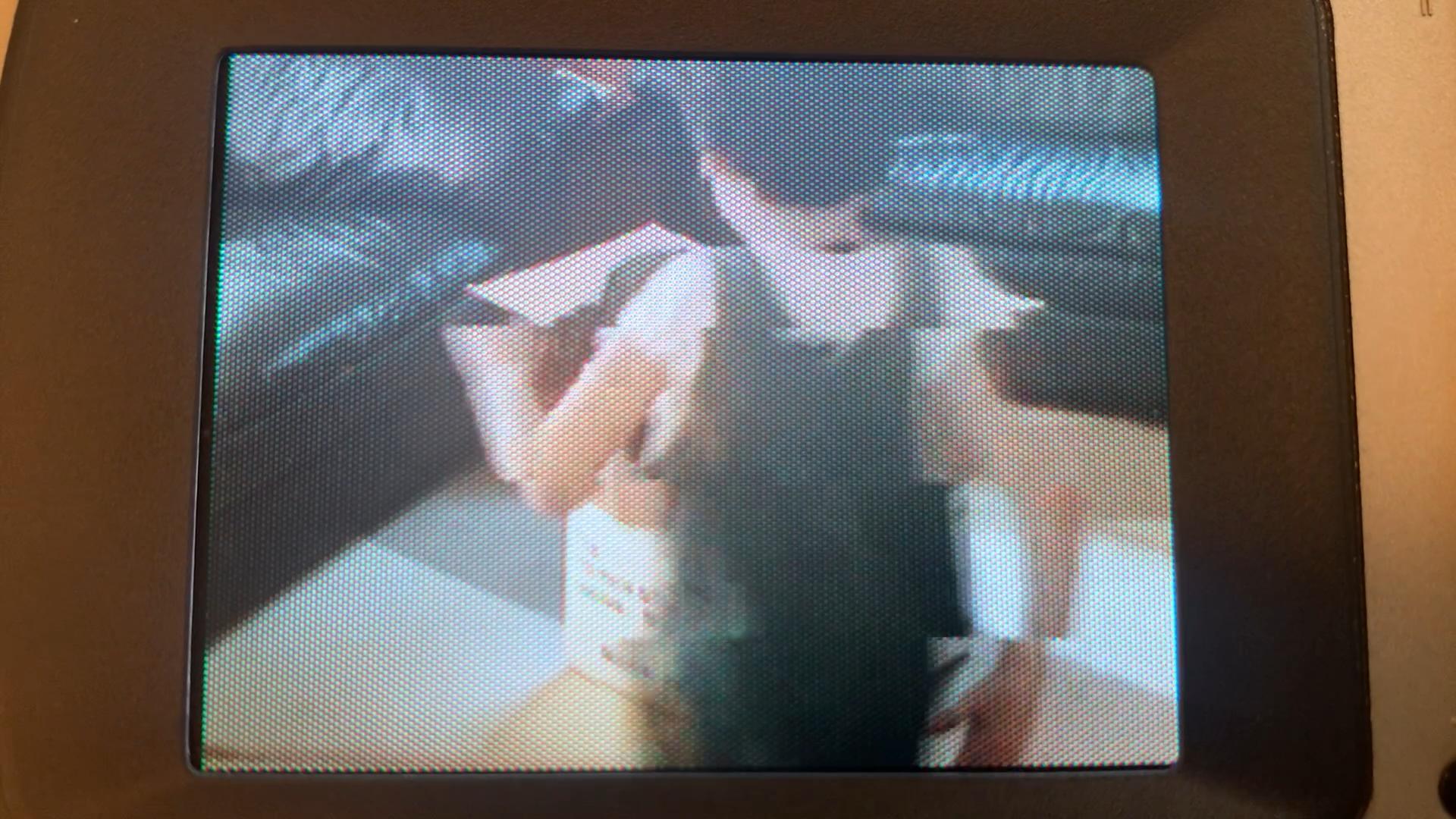

	I see lots of horizontal tearing and some DV (encoding or decoding) errors. The tearing is expected when shooting a display that's not genlocked with the camera -- nothing wrong with the camcorder, tape, or iPhone. The DV errors might be a problem. But this is no way to evaluate the issue. You'll need a firewire cap.
 tearing:
 [Attachment 55591 - Click to enlarge]
 DV errors:
 [Attachment 55592 - Click to enlarge]
