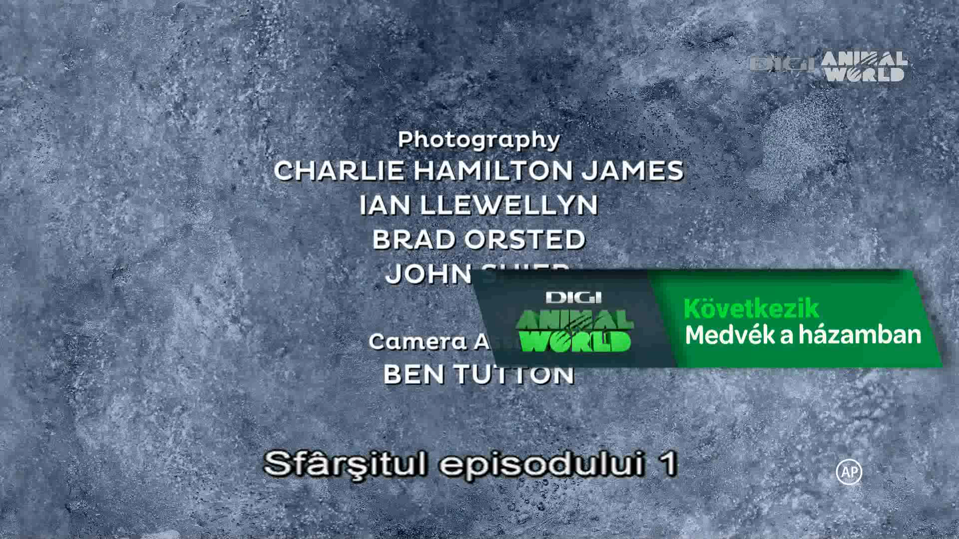

I record TV DVB-C .mpg files with a TV Tuner.
I want to hard encode the DVB Subtitles.

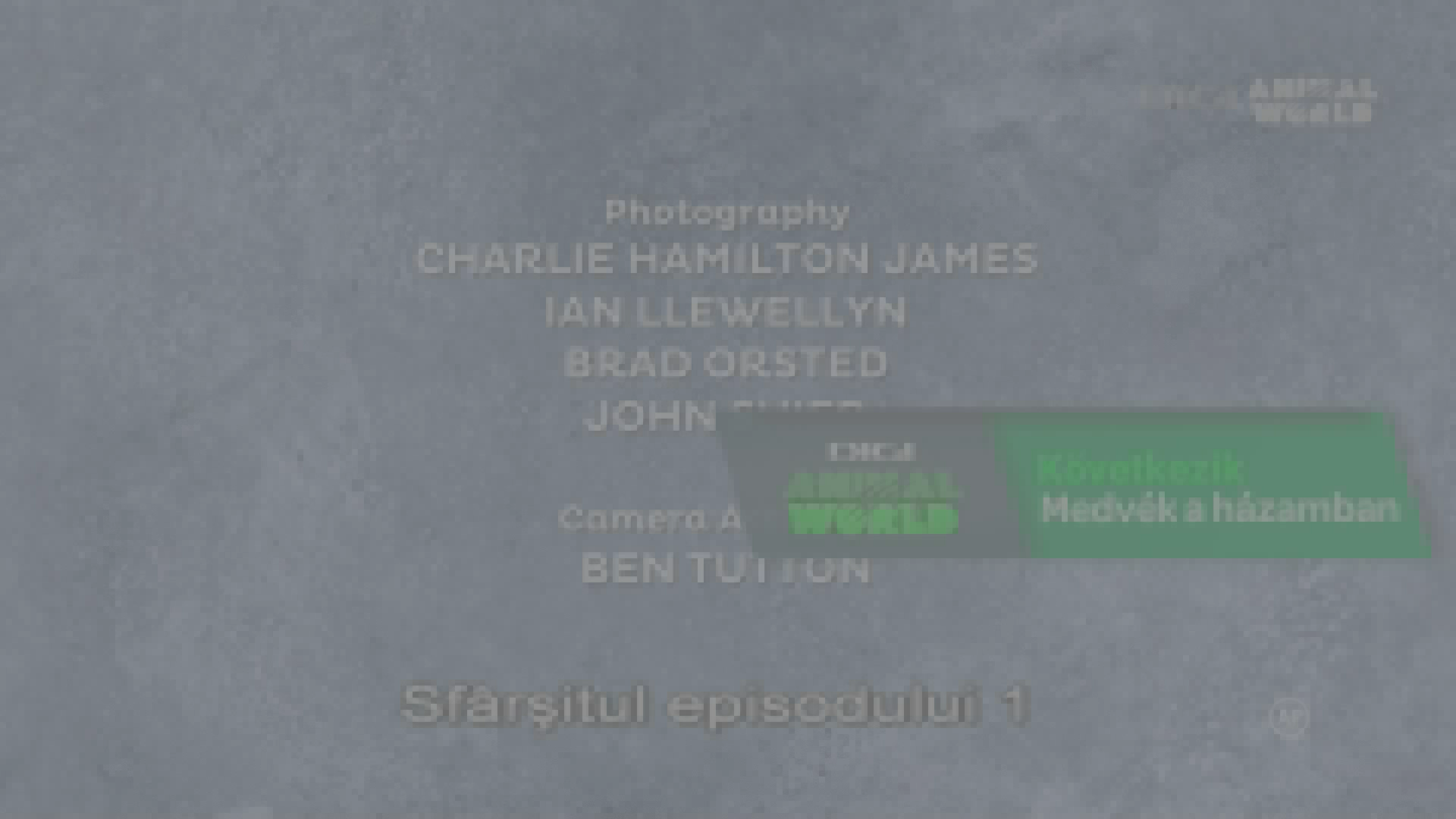

I managed to get the subtitles hard encoded with VLC, but I cannot mange to correctly encode with VLC (Video -H.264 + MP3 (MP4) with 12,000 kb/s bitrate). At this bitrate the processed file is larger than the original.
I get artifact/pixelated frames sometimes.
If I encode with Handbrake the video is fine, no pixelation frames.
Handbrake does a very nice job in terms of video quality and file size, but I cannot burn in DVB Subtitles with Handbrake.
Is there a solution to this?
Here is the original file (254 MB).
The normal/original image:
[Attachment 55574 - Click to enlarge]
The pixelated VLC processed image:
[Attachment 55575 - Click to enlarge]
