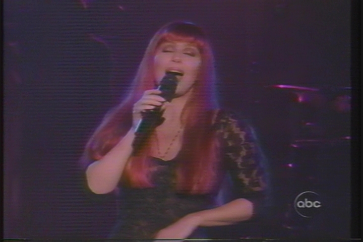

  1. And how might I effectively remove it without too much damage? I have these horizontal, scrolling lines in a few different recordings and cannot figure out how to rid of them.

  3. It's definitely not interlace lines I'm seeing. The lines are scrolling, moving. They are there even after QTGMC
  4. Image
    [Attachment 55576 - Click to enlarge]
    My result after the above script....
  5. Hum bars. Defreq() can reduce those types of lines.
  6. Yep, I missed it. It's some sort of TV channel interference maybe, or interference through the cabling. Requires some more processing......

  9. Originally Posted by Cherbette View Post
    I've fiddled with this one a bit but cannot seem to find a spot to place the box on the spectrum that even minimizes it
    This will remove a lot of it:
    SeparateFields()
    DeFreq(fx=0.0, fy=57.5, sharp=19.2)
    Weave()
    You can probably use it again (maybe multiple times) with a slightly different frequency to remove more.
  10. I appreciate your help jagabo. I will continue to test this method and see if I can get a somewhat clean result
