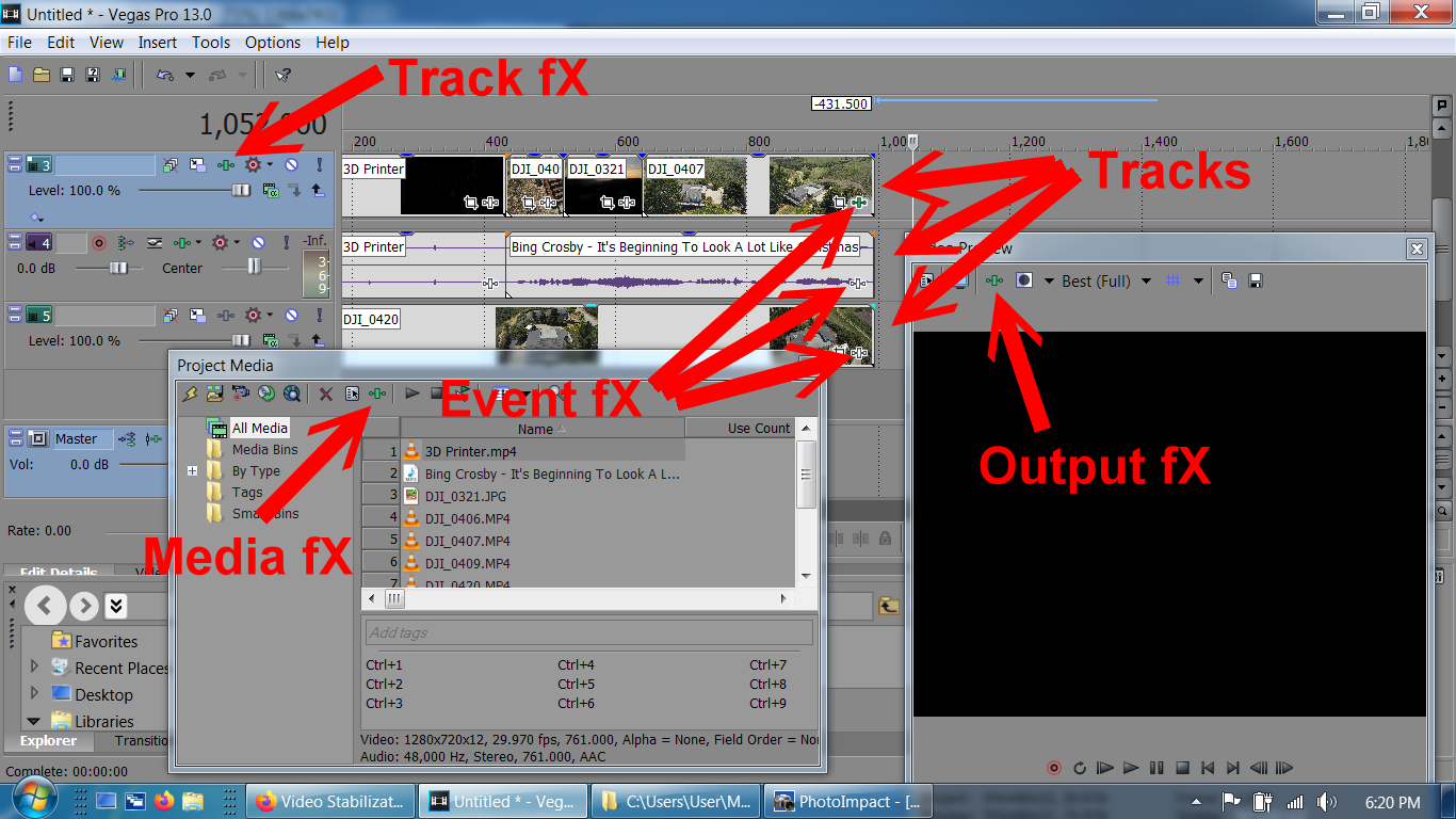

 Here is a screen capture which shows the major components of the user interface.
 A track is the horizontal space which contains your video and also your audio files. You can move the tracks up and down by grabbing the track header (the stuff to the left of the track) up and down.What is a track?
 That is because you haven't added any fX. They turn green after you add one or more effects, but are white before that. Again, this stuff is in both the manual and also in the included help file. I have added arrows on my image to show you where they are for the events, the track, the project media, and for the output.I don't see any green icons anywhere on my screen.
 Once you place audio or video on a timeline, that becomes an event. Initially you have one event for that media file, but as you split that and trim it, the one media file can turn into dozens of events. The media file itself is never changed by splitting into events.What is an event? I have no events.
 Yes, each file you add to your project shows up in the Project Media dialog (see the screen capture below). You can apply an effect (fX) to the entire video file or you can apply it to each event individually.Media means single file?
 It means what you see in the Video Preview dialog or in the Master Bus mixer (which I forgot to show in my screen capture). Actually for audio, there are all sorts of amazing tricks you can do by changing the "audio chain." Consult the manual for a full tutorial on that subject. Remember, Vegas started out as an audio editor and then video was added at a later date.Output? Does that mean whole project?
