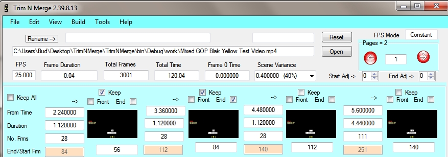

Test Video:Code:ffmpeg -ss 2.240000 -i "C:\Mixed GOP Black Yellow Test Video.mp4" -vframes 56 -c:v copy -c:a copy -y "C:\0_0_Mixed GOP Blak Yellow Test Video.mp4"
[Attachment 55860 - Click to enlarge]
Example cutting 56 frames (28 +28):
[Attachment 55857 - Click to enlarge]

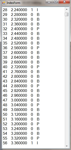

Original Frame times:
[Attachment 55858 - Click to enlarge]

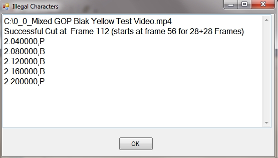

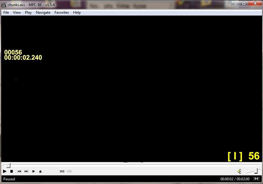

End result:
[Attachment 55859 - Click to enlarge]
Notice the last frame does not include the 3rd segments start time of 4.48 (4.48-2.24=224) End segment is 2.20 for .04 but does not include 2.24 frame time
