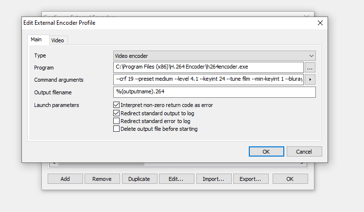

    Also I don't understand why the H.264 Encoder window opens as a popup.

    Are you sure:
    "program": "C:\\Program Files (x86)\\H.264 Encoder\\h264encoder.exe"
    is correct in your profile ?
    Looking at the call it looks like a x264 call not something for h264encoder which is an ffmpeg GUI.
    Cu Selur

    It's this:

  9. Yes, and instead of h264encoder you should use x264 there. The command arguments there are x264 arguments.
    (you need to download x264 and extract it into a folder and then select it there)
    Oct 2020
    Italy
    Now it's OK, tank you
