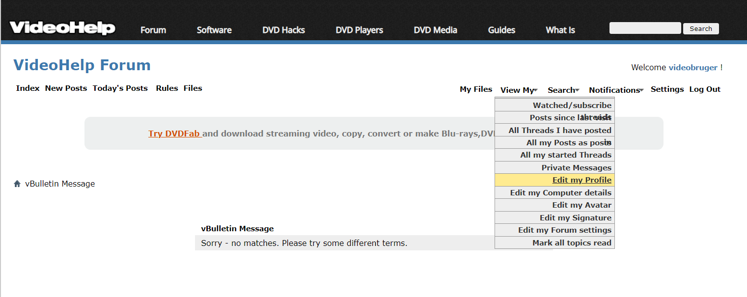

Maybe first you should you should specify your "Computor Details" in your user profile so we can see your OS.
[Attachment 55401 - Click to enlarge]
