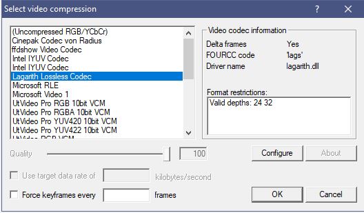

btw: Should "Enable null frames" be checked in the VD compression settings? Right now it isn't and I don't think it was before.Last edited by Jupit0r; 8th Oct 2020 at 12:16.
If you have an copy of the old VirtuaDub you can go to Video -> Compression and see if Lagarith shows up. VirtualDub2 won't work for this because it includes its own private copy of Lagarith. Also keep in mind that if you are using a 32 bit editor/encoder you need 32 bit AviSynth and a 32 bit VFW decoder. If you are running a 64 bit editor/encoder you need 64 bit AviSynth and a 64 bit VFW decoder.
I don't think ffdshow includes a Lagarith decoder (VFW or DirectShow) so it should cause a conflict.
The null frames option only effects compression. The VFW decoder always handles null frames properly regardless of that setting. I recommend you leave the option off to avoid this problem in the future. -

AviSynth 2.6.0 / 2.6.1 Alpha (May 17, 2016) - this version is 32 bit, right? I installed that. I have also AvsPmod_v2.6.3.9_.Windows_x86-32 installed.
I also followed the instructions to install the 32 bit Lagarith on Windows 64 bit (Lagarith.dll is now in the SYSWOW64 directory):
VirtualDub-1.9.11 shows the codec:Code:Installing the 32bit version on Windows 64 Extract all the files to a folder Open up a command prompt (start->run: cmd) Change directories to sysWOW64 ("cd C:\windows\syswow64") Type the following (replace example_path with the actual path to the extracted files), then hit enter: rundll32.exe setupapi.dll,InstallHinfSection DefaultInstall 0 c:\example_path\lagarith.inf
