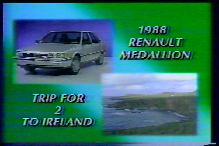

    Unfortunately I am seeing some weird artifacts with one specific area. In testing I have tried multiple captures using different codecs, bypassing TBC, different vcrs, different capture devices...all with the same result. This one little section on the tape gives QTGMC the fits.
    The front of the car should look something like this
    [Attachment 55302 - Click to enlarge]
    QTGMC on its own makes it look like this every other frame, creating some weird flashing errors (trust me it is hard to miss in motion)
    [Attachment 55303 - Click to enlarge]

  4. That's not uncommon. The thin horizontal lines can confuse QTGMC and it ends trying to deinterlace something that doesn't need it. This works pretty well on that particular shot:
    QTGMC()
    QTGMC(InputType=2)
    QTGMC(InputType=2)
    I wouldn't do it routinely though.

    That seems to both solve it half the frames and introduce even more bizarre errors the other frames. Or at least it does when I run it through staxrip. So weird.
    It would seem that old EP tapes from the 80's and QTGMC might not be best friends.
    But using that bit and playing with it some more it looks like I am going to have to stick with a boring de-interlacer up front (tdeint or fielddeinterlace) and then have QTGMC work on it as progressive.
    This actually seems to have the best result and is a little quicker
    tdeint(mode=1)
    QTGMC(InputType=1, Preset="Slow")
    QTGMC(InputType=2, Preset="Medium")
    I think that may be "good enough" for me. Thanks!
