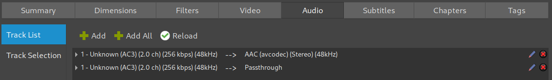

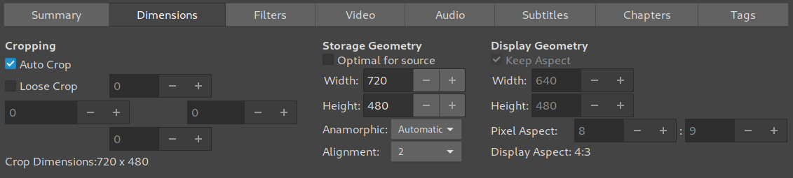

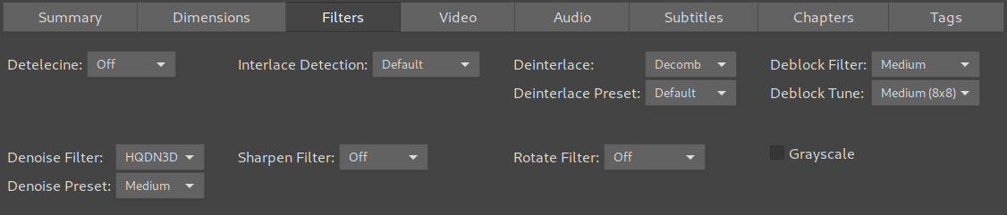

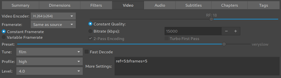

    I would like to convert these videos to a more common/future proof container & codec that would also be amenable to video editing at some point in the future. From the research I've done, it seems that converting to H.264 and storing in an MP4 containers seems to be the way to go. With this in mind, seeing as these videos were originally recorded on much older devices and have already been compressed once to MPEG2, I'm really trying to minimize any further compression or loss of quality.
    I've decided to go with Handbrake for this purpose, but now, to achieve my goal of retaining the most of the quality that I can, I'm a bit unsure of what settings I should use. I've found this blog that seems reasonable, but I wanted advice from you here on this. Please see the settings I've set so far below:
    [Attachment 55148 - Click to enlarge]
    [Attachment 55149 - Click to enlarge]
    [Attachment 55150 - Click to enlarge]
    [Attachment 55151 - Click to enlarge]
    A few questions:
    • Should I set the RF lower, e.g. 12 instead of 18?
    • Should I set Tune to "Film" or "Grain" considering the video cassette origin of the video
    • Framerate: Same as Source or set to 30?
    • What encode level should I use? Is 4.0 suitable?
    • Should I use higher/lower Denoise & Deblock settings considering the video origin?
    Thanks ahead of time!

    My 2 cents:
    1) for source 720x480 or similar: CRF 20
    2) no tune
    3) Framerate as source
    4) Level 4.0 high is fine
    5) no denoise or deblock.
  10. Windows ffmpeg command line remux (linux will be similar):
    ffmpeg -fflags +genpts -i input.vob -c copy output.mpg
    Command line to reencode to h.264+aac in mp4 container:
    ffmpeg -i input.vob -c:v libx264 -preset slow -crf 12 -c:a aac output.mp4

    Thanks ProWo Is this because these feature will mostly have no effect? Or is it because they may ruin/degrade the clips?
