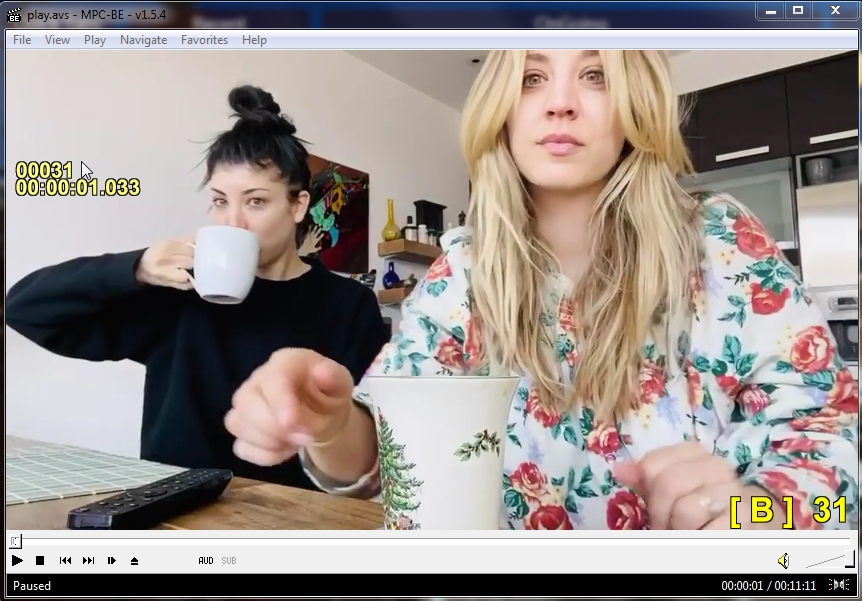

    Another option for maximum information is:
    ffmpegsource2("c:\users\bud\desktop\Instagram.mp4", atrack=-1).converttoRGB
    x = float(Width) / float(Height)
    last.LanczosResize(round(x * 480.0 / 4.0) * 4, 480)
    ShowFrameNumber(scroll=true, x=10, y=127, font="Arial", size=24, text_color=$ffff80)
    ShowTime(x=72, y=144, font="Arial", size=24, text_color=$ffff80)
    ScriptClip(Last, """Subtitle("[ "+Chr(FFPICT_TYPE)+" ]"+"  " +string(current_frame), size=(Height*56.0/720), align=3)""", after_frame=True)
    Outputs in AVS player (Your choice)
    [Attachment 55121 - Click to enlarge]
