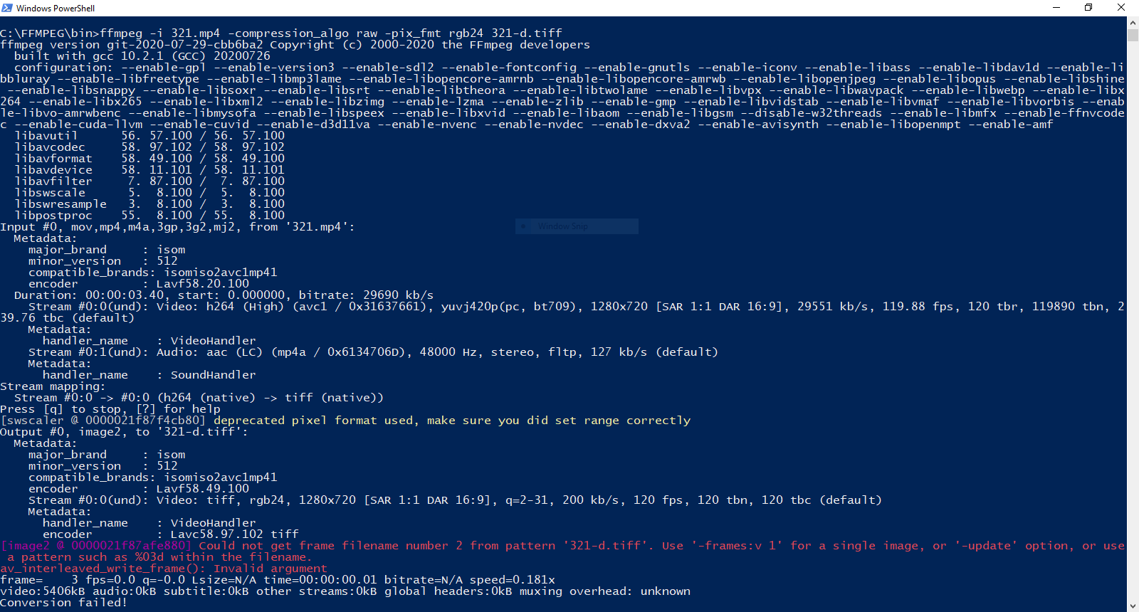

  1. Forgive me in advance for probably not using the right protocol when presenting my problem. So I am trying to make a batch script for FFMPEG conversion to TIFF, which is for a series of video clips which I have named in a numerical series. I am converting from mp4's to TIFF folders, and I have the proper command when entering it from the cmd console.
    The command I am using is for instance:
    ffmpeg -i 321.mp4 -compression_algo raw -pix_fmt rgb24 321-%3d.tiff
    This works great when I just copy and paste into cmd. In order to do the series, I have just manipulated with excel to change the numerical file name, and reformatted in Notepad to just cut and paste for each clip conversion. BUT, when I simply put this in a batch script format, and try to run it, it doesn't convert, and gives me the following:
    [Attachment 55117 - Click to enlarge]
    This is just the first part of a script that I want to write to do all the operations I would like to do, involving copying, moving, and renaming files as necessary for my project, which I have worked out in separate batch scripts already, but I would like to combine into a large script where I can perform all of these actions sequentially on a 20 file block of clips.
    Thanks in advance!!!
  2. Syntax changes slightly in a .bat file vs command line: each "percent" sign (%) must be doubled (%%).

  3. The output has to use %03d for the syntax, for 3 digit padding
    321-%03d.tiff
    would result in
    321-001.tiff
    321-002.tiff
    321-003.tiff
    Use -start_number 0 if you want to start at zero
  4. Thanks! That totally worked like a charm. Is there a resource that might entail these pitfalls when going from command line to batch script? I looked around for this for awhile before asking anyone for help, but it was a difficult search with a lot of trial and error...
  5. @poisondeathray - I actually tried that before posting, but it did not solve my problem. It ended up being the %% vs %. Thanks for the start at 0 advice, it is good to know, but unnecessary in this instance. I am importing the tiffs into Davinci Resolve, and it doesn't care about the numbering, as long as they are in sequential order...
