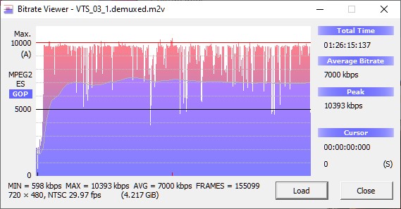

    I have a retail DVD that freezes at various intervals
    I thought maybe remuxing the main title and replacing the original VTS with this one would do the trick,
    but Muxman refused to do it: "Multiplex operation failed. Probaly caused by excessive bitrate"
    I checked the bitrate with Bitrate Viewer. It spikes at more than 10,000 kbps (see image below)

    Would someone please advise how to lower the bitrate of the video, as little intrusively as possible, and leave everything else untouched?

    The max permissible DVD video bitrate is 9.8Mbps. If the diagnosis is to be believed as-is, it it too high. The only way to fix that would be to re-encode at a lower bitrate (either that clip, or better yet its parent clip).
