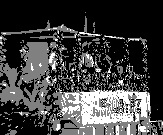

    I had a quick look at your results-italy.mp4 and found that the minimum Y was 12 using 'colorYUV(analyze=true)'. This happened very rarely though.

  3. I had a quick look at your results-italy.mp4 and found that the minimum Y was 12 using 'colorYUV(analyze=true)'.
    Strange. I could be wrong, but I think VirtualDub Histogram starts coloring Bar as red when they below 16 and/or above 335. So It's strange you find a frame with 12. It shouldn't happen. That being said - your checking the final product - FFMPEG and not the raw file. Is it possible the encoding cause that?

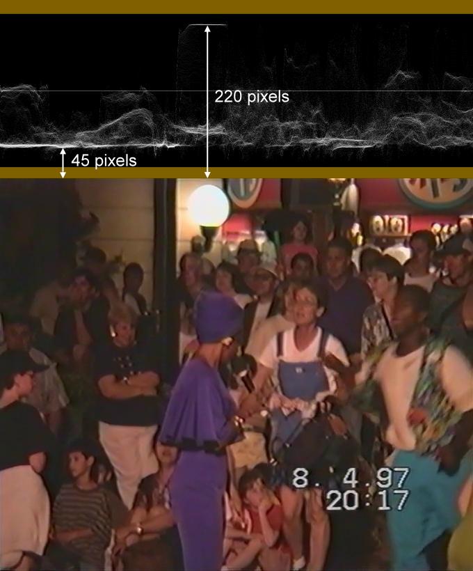

  5. What you guys aren't understanding is that those very low black, and very high white values aren't really parts of the image. They are noise and oversharpening halos. You don't need to retain those. And RGB values read off the screen in VirtualDub are not Y values. The default in VirtualDub is are rec.601 conversion (Y=16-235 to RGB=0-255 contrast expansion). What you need to look at are large areas of black and white. Note that the waverform monitor from TurnRight().Histogram().TurnLeft() is 256 pixels tall -- one pixel for each possible Y value. So you can count the pixels to get Y values:
    [Attachment 55231 - Click to enlarge]
    All the little peaks below 45 and over 220 are oversharpening halos and noise.
    Not every frame will have full black and full white elements. So you also have to use your judgement about whether the brightest and darkest parts of the image/shot/video (even in very large patches) are reflective of the black and white levels.

    Thank you for these explanations, jagabo. I wasn't aware of the y/pixel calibration of the waveform monitor, using a pixel ruler. Now the "Loose" values of colorYUV(analyze=true) attempting to discard noise and halos make sense.

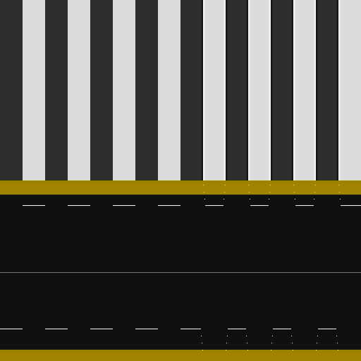

  7. Here's an example that shows oversharpening halos somewhat like those created by VHS decks' sharpening filters:
    # create black/white vertical bars, 16 pixel thick bars, 256 pixels total
    BlankClip(width=32, height=256)
    StackHorizontal(last, last.Invert())
    StackHorizontal(last, last, last, last)
    ConvertToYV12()
    ColorYUV(off_y=-45).ColorYUV(off_y=45) # force blacks to 45
    ColorYUV(off_y=35).ColorYUV(off_y=-35) # force whites to 220
    # show unfiltered bars on the left, sharpened on the right
    StackHorizontal(last, UnsharpMask(radius=3, strength=50, threshold=0))
    HistogramOnBottom()
    ConvertToRGB(matrix="pc.601") # so RGB values on screen reflect Y values from the video
    [Attachment 55232 - Click to enlarge]
    The left half of the image is simply vertical bars of brightness Y=45 and Y=220. The right half is the same bars after a sharpening filter. After sharpening the middle of the dark bars remains at 45 but as you get close to the white bars the values drop to 35, then 25, the 15. The middle of the white bars remains at 220, but as you approach a black bar the values rise to 229, 239, and 249. Those values aren't part of the original image, they were created by the sharpening filter.

    coring was created for VirtualDub compatibility, and it remains true by default for compatibility with older scripts. In the opinion of some, you should always use coring=false if you are working directly with luma values (whether or not your input is 16d-235d).
    I assume Levels change Luma values and therefore it should be False according to "some opinions"?
    I don't have the straight answer to your question, but you could visualize the effect of the 'coring' side-by-side with a script like
    v1=AVISource("your.avi")
    v1=v1.converttoyv16(interlaced=true).crop(20,6,-20,-6)
    v2=v1.levels(42,1.0,220,16,235,coring=true).histogram()
    v3=v1.levels(42,1.0,220,16,235,coring=false).histogram()
    out=stackhorizontal(v2,v3)
    return out
    Coring=true seems to clip the Luma and to compress the Luma range.
    Added:
    You may also run jagabo's script of post #30 and change it to 'coring=true' in his 'function levels_gamma' to see what happens.
  17. Generally you want to use coring=false to make sure illegal values are handled the same as legal values rather than being crushed. Note that the original levels filter in AviSynth worked in RGB after a rec.601 conversion. So all illegal levels (Y<16, Y>235) were crushed before the levels adjustments were applied (and crushed again after the adjustments are applied). The defaults in the AviSynth filter were to emulate that.
    Regarding quantization errors here's an extreme example:
    Levels(45,1.0,220,127,129,coring=false)
    Levels(127,1.0,129,16,235,coring=false)
    GreyScale()
    [Attachment 55243 - Click to enlarge]
    With the first line the entire video is converted to only three Y values, 127, 128, and 129. With the second line those three values are spread out to 16, 126, 235. GreyScale() is used to remove the chroma to make the luma changes more obvious. All the in-between values that were lost in the first step cannot be recovered in the second step.
    The dither option basically adds ordered noise to reduce this banding/posterization. It works ok for small levels adjustments. If you enable the option with the above sequence you'll see what it does.
    If you think the black level is too low after the 45/220 adjustment you can change the values to give you what you want.
    Levels(45, 1.0, 220, 25, 235, coring=false)
    Or increase the gamma to increase shadow detail:
    Levels(45, 1.5, 220, 16, 235, coring=false)
    But correct me if I'm wrong, in the situation here, Everything below 45 is noise, and everything above 220 is also noise. So technically, we don't use anything for a second Levels use? because all we did is to dump sharping, halos etc and not read details?
    I was simulating what would happen if you adjust levels in your QTGMC pre-filtering step, then load those pre-filtered clips into an editor and apply a a final brightness and contrast adjustment. I just skipped the save/reload step. And used outrageous adjustments to make problem visually obvious.
    Say for example you apply a Y' = Y * 1.4 adjustment in one step, then later apply a Y' = Y * 1.3 adjustment in a second step. After the first step a pixel with a Y value of 1 becomes 1.4. But the video output is limited to integers. So that 1.4 is rounded down to 1. Then in the second adjustment that 1 becomes 1.3. Which rounds down to 1 again. But if you had applied Y' = Y * (1.4*1.3) in a single step you get 1.82 which rounds up to 2. So doing the two adjustments in one step is more accurate than doing it in two smaller steps.
    When does it become noticeable? As you said - you shared very extreme example. Change 40 to 16 and then in another video moving 16 to 25. Was that be very noticeable?

  24. Originally Posted by jagabo View Post
    Interesting thoughts. So If I understand it correctly this also means that low luma values are more affected than high luma values. For Y=90, for example, both cases (i.e. one step and 2 steps) would result in y'=164 (rounded integer).
  25. Originally Posted by Okiba View Post
    I tried AutoLevels, and I was indeed unable to identify difference between the results of the plugin to the manual Level we set (45,230).
    One of the pitfalls with 'auto' adjustments is that they may produce flicker, or tweak fade-in/fade-outs unduly. So keep an eye on it.
  26. Originally Posted by Sharc View Post
    Higher Y values are effected by the same amount. 90 may become 164 both ways, just as 2 becomes 4 both ways. But 91 becomes 165 and 166.
