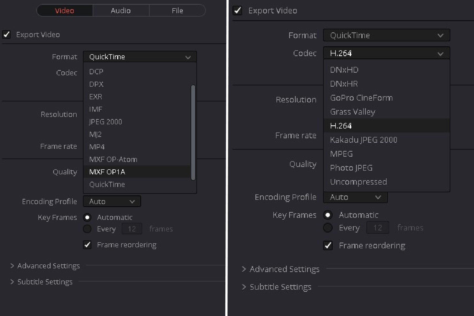

Lordsmurf you are sadly misinformed. You are not limited to h264 in the free version of Resolve. You just cannot go above UHD resolution, and cannot use 10bit video.
[Attachment 55100 - Click to enlarge]Canon C100 mk2 - Dell XPS8700 i7 - Win 10 - 24gb RAM - GTX 1060/6GB - DaVinci Resolve Studio 18.6.3 - Blackmagic Speed Editor - Presonus Faderport 1 - 3 calibrated screens -

For Windows?
The only thing interesting in that list is DNxHD.
I'll look again, but for SD, all I saw was H.264 last time I had it installed, maybe 6 months ago.Want my help? Ask here! (not via PM!)

Lordsmurf, yes the options are limited for SD but you can use MXF. I would suggest that the majority of people using Resolve are working in HD or UHD 16x9. As to grading, you have far more control in Resolve. Most feature films, regardless of the platform they are edited in, are graded in the color section of Resolve. DaVinci has been the de facto grading software for many years, originally costing many thousands of dollars.
