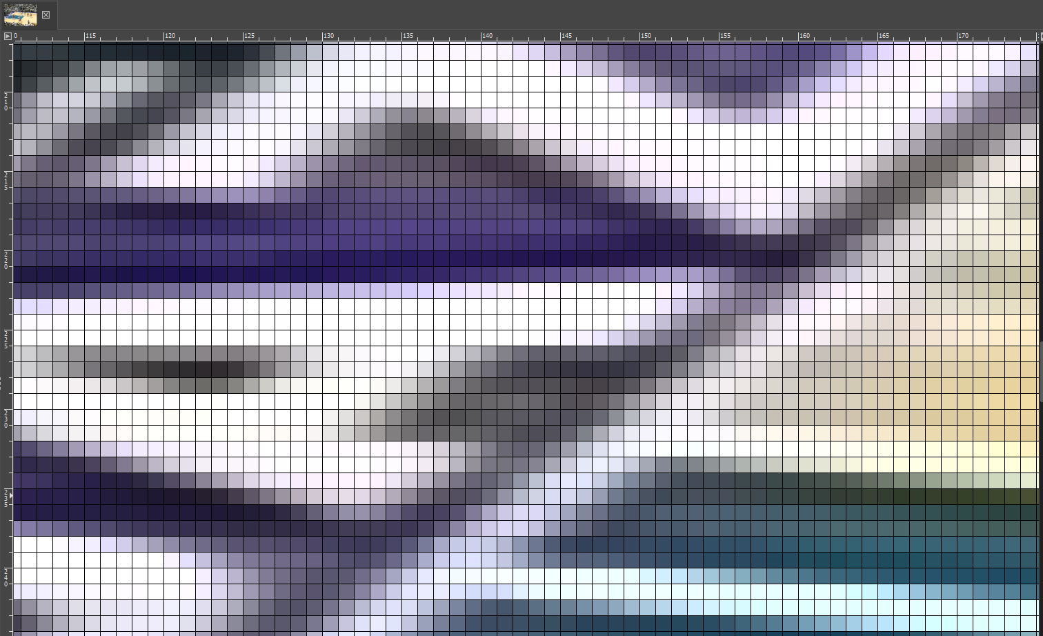

    Let's take a look, shall we?
    Here is OP's original raw avi, and I've taken a single frame exported as a bitmap in virtualdub. Then using a single pixel grid we can zoom in.
    [Attachment 55130 - Click to enlarge]
    [Attachment 55131 - Click to enlarge]
    THAT is what the spline resize is working with. It has no idea about the source material being "effectively" 320 lines of horizontal resolution. There are no leftover ghost traces of an analog signal. It is absolutely incapable of differentiating between a VHS source and a DVD source. There are no perfect groupings of 3 or so pixels all with the same luma and chroma to the point that "Several pixels can be considered as one analog state of change in luma signal".
    Once a VHS has been captured digitally the old analog rules for the "effective resolution" of the image no longer apply. Period.
    Now you could argue that the human eye can barely tell the different between 720 and 640 and so what is the big deal with resizing like that. Fair enough. But arguing that adding 60 pixels vertically is "disastrous" while trusting a script to take away 80 pixels horizontally is "ok" is a tough sell.
    If OP captured at 640 X 480 then I wouldn't recommend stretching to 720 X 540. That adds nothing. But they aren't capturing at 640 X 480.
    tldr, OP you did nothing wrong. Ignore these people telling you to crop to 640 X 480. They are working off of bad information leftover from the early 2000's.
