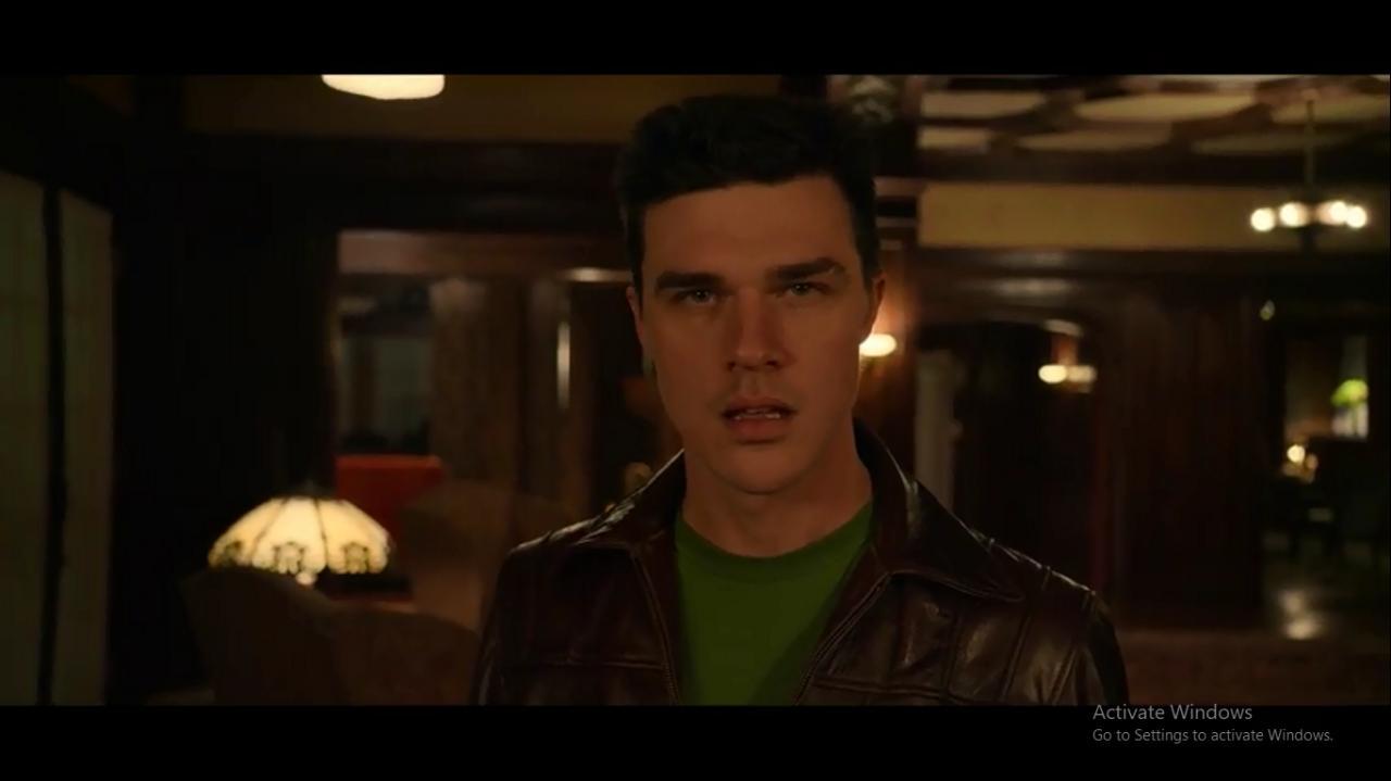

  1. Hello everyone. I'm new to ffmpeg and recently tried to encode a video
    Image #1 : this is the source

    As you can see Image #2 color is more like the source. Can anyone suggest any filter in ffmpeg that will do such a thing? I've used sharpen filter but the color was still far from the source.
  2. It's mostly a rec.601 vs. rec709 colormatrix issue. There's also a slight brightness difference. What was your ffmpeg command line? And MediaInfo properties (text mode) of the source video and the video you want to match.

  4. The source isn't marked as bt.709 (rec.709) but since it's HD the player may be assuming bt.709. The sample you're trying to match is marked as bt.709. My guess is you need to mark your video as bt.709. Add "-colorspace bt709" to your ffmpeg command line.
    The general rule is that HD video uses rec.709 and SD video uses rec.601. The exact behavior of players vary, but in the absence of the flag indicating which to use some players assume rec.709 for HD, rec.601 for SD. Some players ignore the flag and always use the same one.

    I Just tried it and the problem was fixed. thanks for your help
