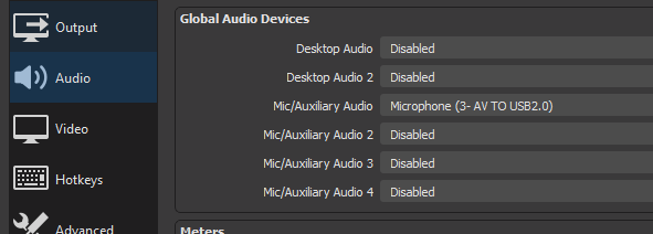

    I came across something similar using an Easycap AV TO USB2.0 device. Make sure when drivers are installed the audio driver is also done.
    In OBS in Settings->Audio, select the device called (Microphone AV TO USB2.0) - see first attachment
    You also don't need any adaptors, OBS can convert the mono signal from one of the rca jacks to "stereo" just by ticking the Mono section in Advanced Audio Properties - see second attachment.

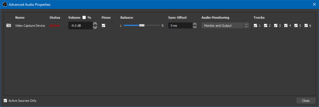

    OK sorry, you won't hear the audio through your PC speakers, but it should be in the recording... you need to go "Advanced Audio Properties" and select "Monitor and Output" under Audio Monitoring as in the attachment.
