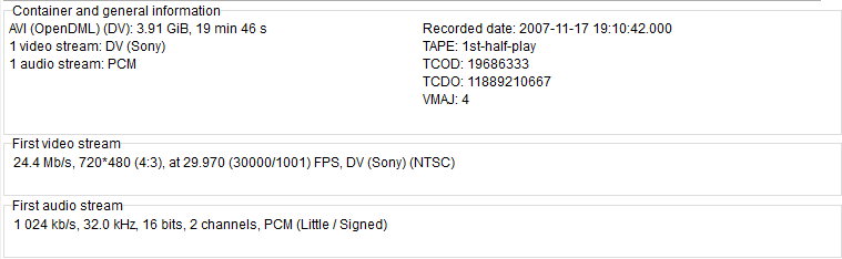

    The rest of the files (.001, .002) will not open so I am not sure Easy Video Joiner will help. I uses Mediainfo on one of the files that doesn't play... Image attached.
    DV-dif? Can these be recovered?

  5. Install a DV codec. Probably Cedocida is best.
  6. Thanks. Installed Cedocida and tried playing in VLC. No luck.

  8. I'm pretty sure that the 001 extension indicates that the file was captured but never combined with the other files. That is why you are getting the prompt to reindex the file. I would make a copy of the 001 files, rename them to AVI, reindex, and then combine in your favorite NLE (or VirtualDub). I doubt that you need to install an y new codecs because that is almost certainly not your problem.

    No, abolibibelot, it was NOT a file splitter app. It was from a capture app. Remember, in the early days of DV, the AVI spec was still v1.0, not OpenDML 2.0 style (and was also primarily Type1, not Type2). That meant it couldn't grow larger than 4GB. So a 1hr tape (=~13GB) would have to be captured and saved as segments to get around that limitation.
