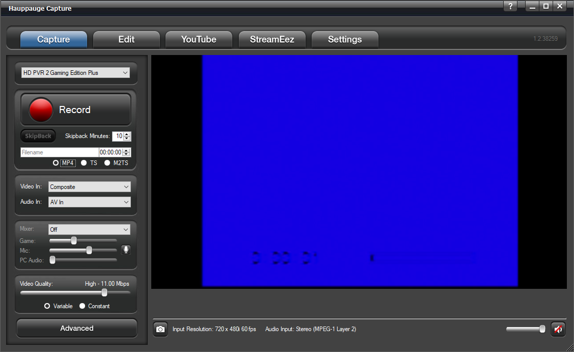

    You probably do have a different interface. This is what I see:
    I do use HCWClear. During this adventure, I've used it often. I remember the installer used to prompt me about NTSC vs PAL (at least I'm pretty sure it did), but installing the latest version and a few earlier versions didn't do that. I want to assume the composite cable setting is on NTSC because i never would have used PAL in North America. I do reboot after removing or reinstalling the software. I did remove the power supply and leave it off for a few minutes last night to see if that made a difference - i had been removing it for a second or two previous, especially when moving the connection from one computer to the other (as i kept wanting to make sure it still worked on the laptop).
    The screenshot you provided is pretty accurate as far as the interface goes until I look closer - I don't have the dropdown for "Standard" or "Aspect" after selecting Composite (or Component).
    [Attachment 54992 - Click to enlarge]

    1. If indeed the unit has internally converted to 60 fps it can be reduced to 30 fps in the Video Scaler section
    I did try different settings in the Video scaler. Everything I did wanted to convert 720x480i to 720x480 at 60 fps (no matter what I selected). Nothing changed the actual picture available to watch/record.
    2. Have you tried toggling the "Use Hardware Acceleration" (Graphics Card) button in general settings ?
    I could not find hardware acceleration as an option on my graphics card. right now, my PC doesn't have that software (after re-installing and not adding any drivers).
  27. The hardware in the PC is not the problem. The hardware in the PC is not the problem. The hardware in the PC is not the problem. The hardware in the PC is not the problem.
    So forget about the graphics card, shielding in the computer etc. I've already said this several times, so I won't annoy people by posting it again.
    Something is telling your external device (the Hauppauge PVR2) to digitize the video incorrectly. It then passes that video, via USB, into your computer. The USB cannot corrupt video in the manner you show.
    One other test would be to find a third computer and install the software there.
    Also, I think you mentioned something about Windows 10 on the faulty computer, and if the two versions of Windows are not the same, there could be some sort of driver issue that is specific to some version of Windows.
    I didn't mention it, but I did my tests on a Windows 7 computer (I don't have Win 8 or 10 because they are evil).
    You could also try some alternative capture software, although as I remember when I initially got my PVR2 3-4 years ago, when I looked at these other programs, they actually used the same underlying drivers.
    Since I suspect drivers, you might see if you can figure out the version numbers for the drivers on each machine. You could go to Device Manager (found in the Control Panel), find the PVR2 device, right click, and inspect everything you find. Repeat for the other computer and see if you detect any differences.
  28. Originally Posted by johnmeyer View Post
    When you say "Something is telling your external device", do you mean drivers or software on the computer? Or hardware/firmware the Hauppauge PVR2? It sounds like drivers, which was my original thought.
    Unfortunately I don't have access to a 3rd computer to test with.
    Laptop - Microsoft Windows Version 2004 (OS Build 19041.508), Windows 10 Home
    PC - Microsoft Windows Version 2004 (OS Build 19041.450), Windows 10 Home -- FRESH INSTALL, NO WINDOWS UPDATES (as of this evening)
    Is there anything in particular that I'm looking for with those drivers?
    Laptop - Hauppauge Capture 1.2.38259; Driver Date: 4/29/2019; Driver Version: 1.6.37119.0
    PC - Hauppauge Capture 1.2.38259; Driver Date: 4/29/2019; Driver Version: 1.6.37119.0
    The hardware acceleration 'toggle' is in the Hauppauge settings not the actual GPU.
    But is your Windows install actually new or just a restore of what was saved to external media ? The latter will have any potential conflicts that were previously there.
    I see no reaction to my comment about Hauppauge Capture wanting to access my non-existent webcam. But if your Windows is now 'clean' ie no drivers etc. for any other external equipment I really would try a fresh install of Hauppauge Capture as well.
  30. Originally Posted by DB83 View Post
    Ah. that. Yes, I did toggle that. No luck
    I used the Windows Media Creation tool with a USB drive and then I went as far as doing Reset PC. I was hoping to be able to format the C drive and re-install windows from scratch, and that's the closest I got, but maybe I still need to take that extra step.
    On my PC, I do not have a webcam or a microphone. I have not seen any issues with it trying to access my webcam. One interesting thing is that on my laptop, it wants access to the microphone (for no apparent reason), but on the PC, where there is no microphone, it doesn't care. The software itself does have a feature which uses a microphone, but I'm not trying to use it.
    With my "reset" PC, I did a fresh install of Hauppauge Capture and it still has the bad picture. I don't know if I need to go as far as actually reformatting the harddrive (outside of what "Reset PC" does) and re-installing. I'd have to do a little bit of work to take one of my additional drives and make it available to do that.
