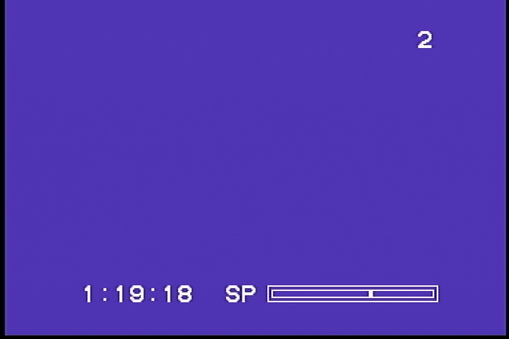

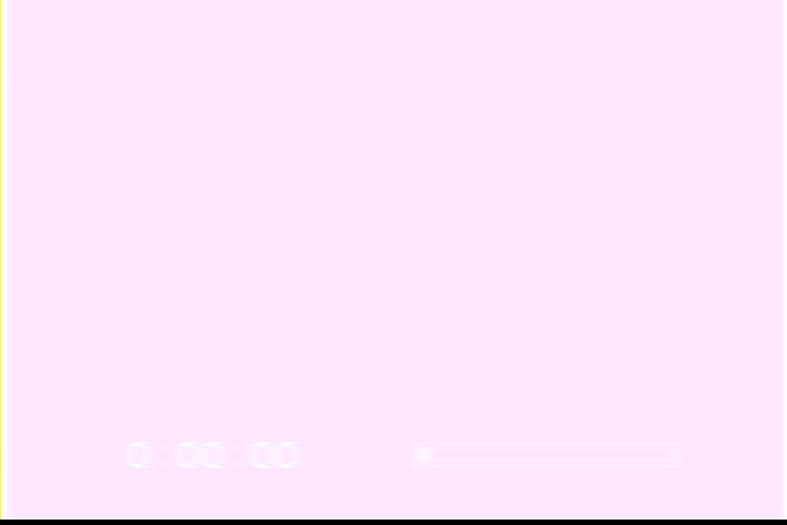

  1. I'm trying to record from my VCR (composite cables) through a Hauppauge HDPVR2 device to my PC (via USB), and the video comes very washed out (not sure if that's the correct term). It's unusable.
    [Attachment 54966 - Click to enlarge]
    Sometimes it comes out with almost the opposite coloring.
    [Attachment 54968 - Click to enlarge]
    When I watch/record from my cable box (component cables) on this PC, it comes up just fine.
    When I connect the VCR (same composite cables) directly to my TV, it comes up just fine.

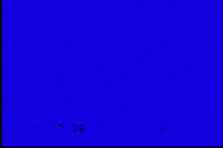

    And when I connect my VCR to the HDPVR2 and connect the USB to my laptop, it comes up just fine. This is what it's supposed to look like.
    [Attachment 54967 - Click to enlarge]
    So it's likely something on this PC, but I'm not sure what. I've reinstalled the latest Hauppauge Capture software and drivers, removed (and re-detected) my AMD graphics drivers, and reinstalled the latest graphics drivers on this PC with no luck. I've disconnected and reconnected the wires on the different devices a few times. I've tried looking for anything with conflicting drivers and anything that might not be installed on my laptop that's on my PC. I don't want to completely reinstall Windows (yet).

  3. Composite works with the same equipment (and wires) on my laptop. I did try changing the video cable used in this setup with another one and it didn't make a difference. Let me see if I can (inexpensively) change the adaptor. But it's a single adaptor for both component and composite video and the component video works just fine. It's designed as a single adaptor for both component and composite video.

  9. Here is a short video recorded from the bad connection:
    https://youtu.be/mjPX6tsxo7s
    Here is a short video recorded from the good connection of the same 10 seconds:
    https://youtu.be/_L0G7mzYIYQ
