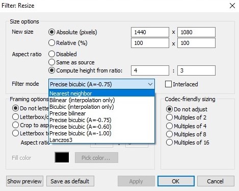

    I prefer vdub so I can watch the frame, For youtube I usually do a crop followed by a rsize in one single operation, Vdub allows me to see what I'm cropping. Wonder which option is the best:

  7. Originally Posted by dellsam34 View Post
    I use Gordian Knot to figure my crop values. I open the AVS in it, do the cropping to the video and add the values it gives to the AVS for further work. GKnot allows you to see what you're doing.
    Also, you can figure out the crop values in VDub and then add them to the AVS. And, as jagabo implies, nnedi3_rpow2() is better than any VDub resizer for upscaling.

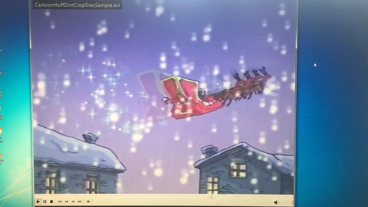

    Jan 2016
    Ok here is a video grab of both playing in repeat mode, the size of the window don’t matter I already tried playing both files at the same window size but the same effect.
  17. That's definitely a playback problem.
  18. Capturing Memories dellsam34's Avatar
    Jan 2016
    I think I narrowed it down to the HuffYUV compressor, When I saved a copy in lossless AVI it played smooth just like the original at least in VLC, MPC-HC still stuttered a little bit, At this point I think it's my playback hardware. Will a memory increase help? I have 5GB now.
  19. Why is your screen cap in post #16 fulll of blended frames?
    [Attachment 54985 - Click to enlarge]
    Blending like that can be seen in both the SD and HD portions of that MOV file. Neither AVI video has any blending like that. Are you using some frame rate conversion in the player? Heavy temporal noise filters?
