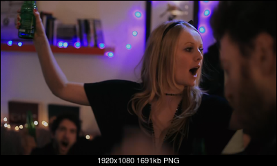

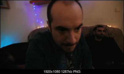

    However on this screenshot there're lines visible, especially noticable on the garland (blue lights):

    The crap in your second image has nothing to do with deinterlacing. It's errors decoding the source video -- common with ffvideosource(). Try using LSmash's LWlibavVideoSource() instead.
    Yep, thanks for that. I was using ffvideosource only in AvsPmod to make screenshots with overlay text. And LSmash's plugin to index in MeGUI.
    This kind of aliasing is probably not caused by interlacing (this scene doesn't look like heavy horizontal motion), but rather by YUV 4:2:0 chroma subsampling artifacts. Rather highly saturated red and blue has only half the resolution, compared to average brightness.
  9. Alright, it's a progressive video then. Thank you.
    How can I deal with it? If I encode to 720p it looks good without any of these lines, they just blend in (is it correct terminology?). However in 1080p they look almost like in the source (depending on x264 settings).
  10. The problem around the blue lights is because of the interlaced encoding. You can get rid of it with:

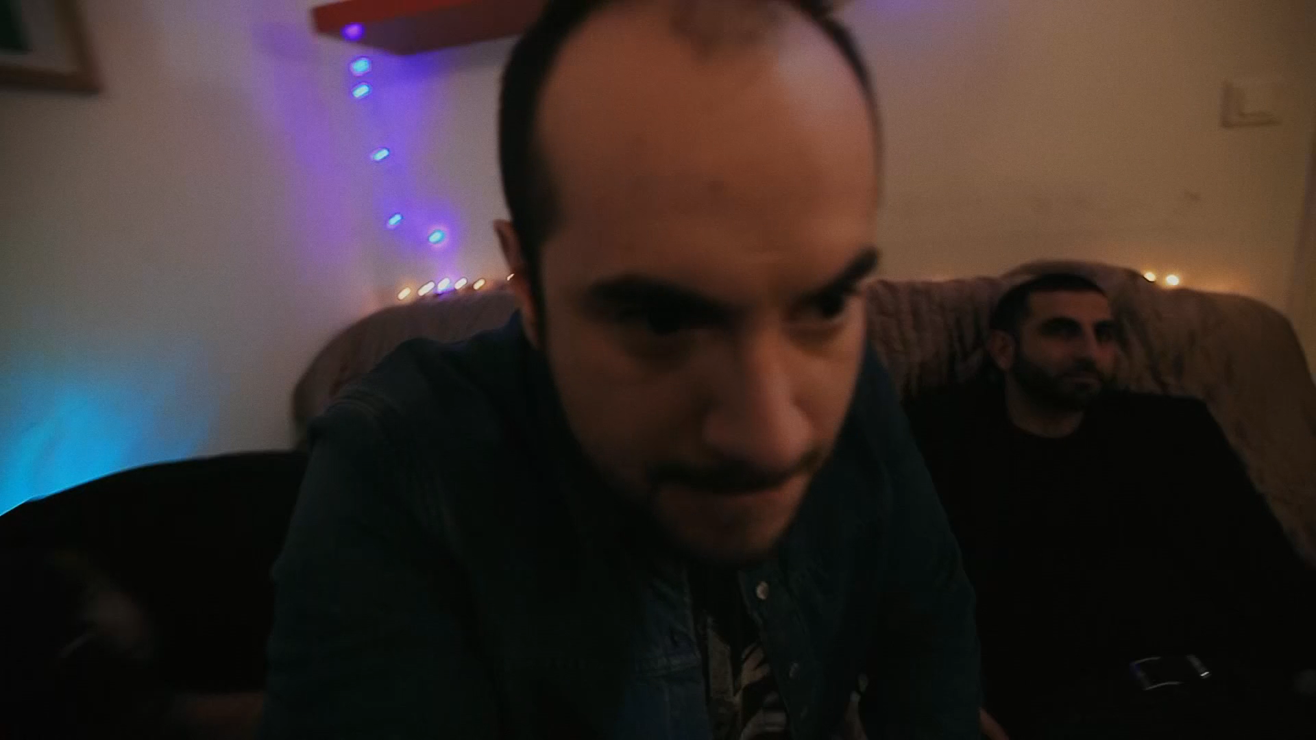

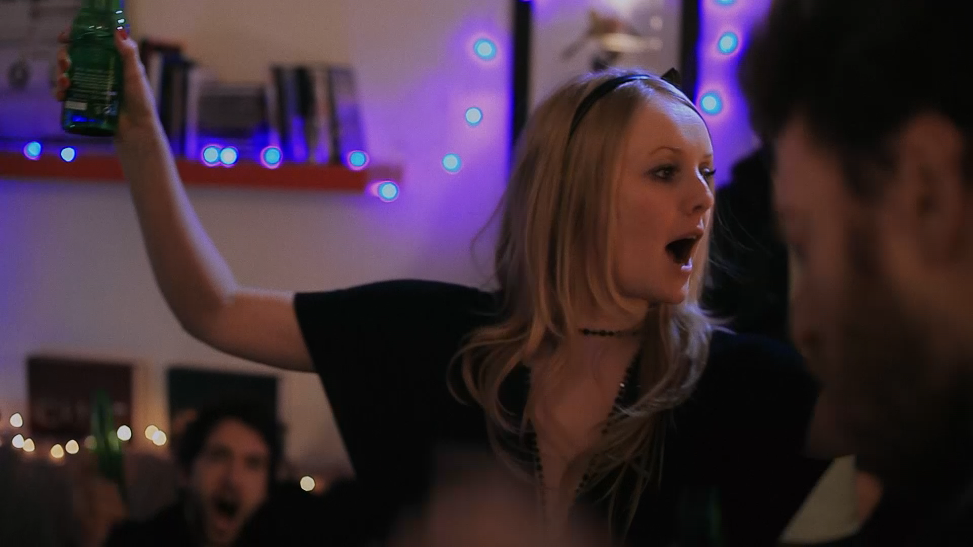

    And also there're some blocks (sorry, I don't know the proper terminology) on the edges of the blue lights between pink and blue. Should I do something to get rid of them or it's normal with this source?
